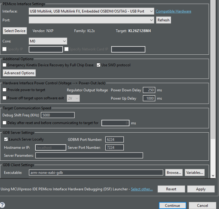

My debugger configuration:

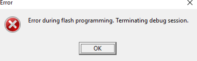

And if I try to debug my board, I have this error:
Is there any solutions?

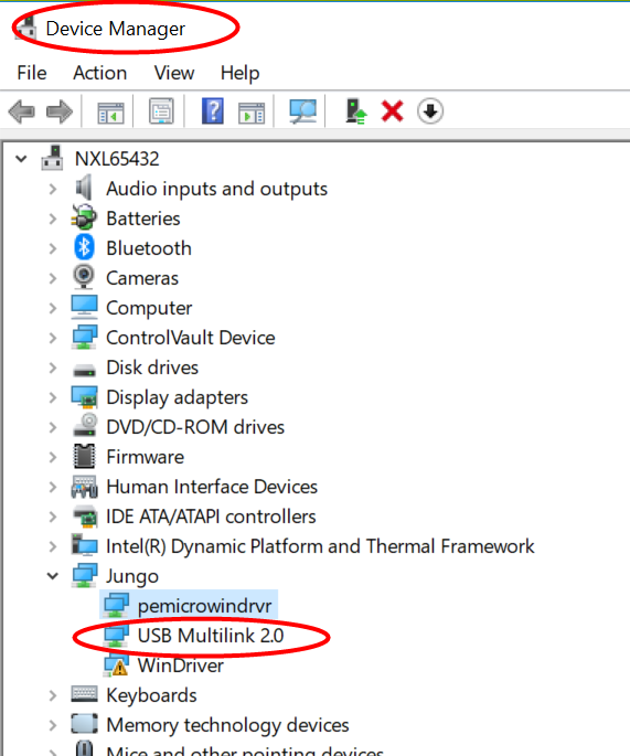

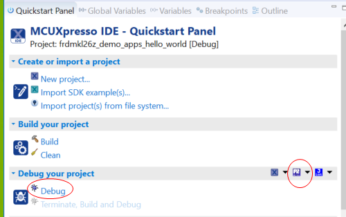

Hello Bony X,
Please check the if recognize the  USB port on "Device Manager" :
And you can try to click Debug button on "Quickstart Panel" to debug :pastedImage_2.png
I test it on my side , it can work well .
Hope it helps,

johnny_pe
Hi Bony,
The PEMICRO settings dialog in the debugger configuration shows that you don't have an assigned USB port for the Multilink Universal. Please try pressing the Refresh list button.
It might be that your USB port is locked out due to another open PEMicro application or MCUXPRESSO process.

BlackNight
Your debugger configuration shows that you don't have a USB Port assigned for your probe connection?
