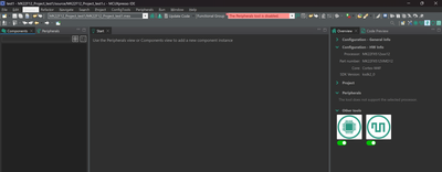

Hi All,
I am using MK22FX512VMD12 controller and trying to configure few port pins and a serial port to begin with. I was able to create a new project for MK22FX512VMD12 (as there are no specific boards available for this controller) and able to configure the GPIO, and then trying to configure the UART and when I tried, I am seeing a message that "The tool does not support the selected processor". If any of you have any suggestions please let me know.
With best regards,
//P

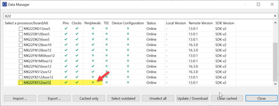

EdwinHz
Hi @phanids,
Unfortunately, the Periferals Tool does not support the MK22FX512xxx12, as you can see from this picture of the "Data Manager" window:
Please proceed with a manual implementation of the peripherals rather than relying on Peripherals Tool.
BR,
Edwin.
