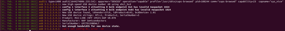

I am using Lenovo Docking. The docking station works fine with other USB devices i have but when MCU-Link come into the picture the troubles begins. The MCU-Link (Specifically, SWD) is reporting an invalid endpoint buffer size (See sudo dmesg -T image  ). with that, i am not able to use more than ONE USB device plugged into the Docking station.

-did you see some errors when you connect the mcu-link in your dmesg terminal?
-sudo tail -f /var/log/syslog
Screenshot from 2022-02-08 08-16-48.pngScreenshot from 2022-02-08 08-16-48.png
-sudo dmesg -T
Screenshot from 2022-02-08 08-20-17.pngScreenshot from 2022-02-08 08-20-17.png

Windows is sloppy compared to Linux.
Linux may care about the bad packet size in the descriptor for endpoint 5.
The not enough bandwidth message could be related to that, or that hub is out of capacity.
Are there different results if move to a different USB port on a different hub?

After some investigation, plugging out all USB devices from the Laptop, the machine finally enumerated MCU-Link.
When i tried to plug in keyboard and mouse while observing the syslog i saw that it could not enumerate the last USB device plugged, with that it showed that it is a kernel issue and not the MCU-Link issue.
