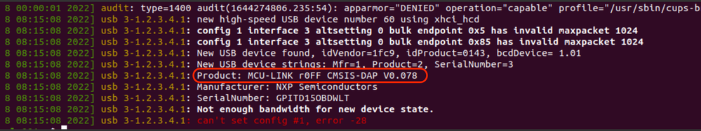

Hi ,
I have a MCU-LINK which i have used with windows, recently i switched to Ubuntu and after installing the MCUXpreesso ide (mcuxpressoide-11.5.0_7232.x86_64.deb , MCUXpresso IDE v11.5.0 [Build 7232] [2022-01-11]) and MCU-LINK (MCU-LINK_installer_2.250_Linux).
MCUXpresso IDE (redlinkserv) can not detect the probes.
The redlinkserv starts normally, and i killed redlinkserv after each try.
The MCU LINK gets detected bu the OS :
Screenshot from 2022-02-01 14-31-42.pngScreenshot from 2022-02-01 14-31-42.png
I have tried to update firmware on MCU LINK. Reinstalled MCUXpresso IDE and MCU LINK software.

Hi @4Rawi ,
from the dmesg log, it seems you are using an older/outdated firmware version?
Can you check and update the firmware (see https://www.nxp.com/document/guide/getting-started-with-the-mcu-link:GS-MCU-LINK)
The current version is 2.250:
from https://www.nxp.com/design/microcontrollers-developer-resources/mcu-link-debug-probe:MCU-LINK#t996
I hope this helps,
Erich

radu_lazarescu
Hi @4Rawi,
Thank you for providing the additional details.
From the dmesg logs I can see the probe is running an old version of the firmware.
Could you please update to the most recent version V2.250?
The Getting Started guide on the MCU-Link Debug Probe page shows the firmware update procedure:

4Rawi
Hi @bobpaddock and @CarlosGarabito ,
I have inestigated further and have some other findings:
I am using Lenovo Docking. The docking station works fine with other USB devices i have but when MCU-Link come into the picture the troubles begins. The MCU-Link (Specifically, SWD) is reporting an invalid endpoint buffer size (See sudo dmesg -T image  ). with that, i am not able to use more than ONE USB device plugged into the Docking station.
I changed the Docking station with one similar, i got the same error.
When i disables SWD on MCU-Link (everything works fine but i am not able to MCU-Link as a debugger probe).
Could you please help with that?

4Rawi
After some investigation, plugging out all USB devices from the Laptop, the machine finally enumerated MCU-Link.
When i tried to plug in keyboard and mouse while observing the syslog i saw that it could not enumerate the last USB device plugged, with that it showed that it is a kernel issue and not the MCU-Link issue.
Thank you for your help!
