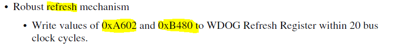

Thanks for your reply. You mean that we needn't the "wdog_unlock" process each time we feed the dog?
3,664 Views
mjbcswitzerland
Specialist V
Yanli
You ONLY need to use the unlock sequence when writing configuration changes to the wathdog, but you DO need to protect the sequence again interrupts.
An interrupt occuring between the two refresh writes will require 22 clock cycles to save and restore the stack, or 56 if it has an FPU. Assuming your bus clock is half your core clock, and you don't use a part with FPU, you don't need to disable interrupts as long as you:
- have only one interrupt routine that can ever occur
- this interrupt routine requires less that 18 clock cycles to complete
Otherwise you need it - unless you can accept your product having a high probability of resetting each time you service its watchdog (as you already have seen).

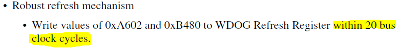

yanlicheng
Hi, Mark:
From your explanation, you mean that:
(1)  "feed the watchdog" doesn't  belong  to  "writing configuration changes to the watchdog", so I needn't do the 'unlock' process.
(2) When I "feed the watchdog" (write 2 different values to WDOG Refresh Register),  interrupt will produce and cost more than "20 bus clock". So I need "DisableInterrupts" first. The feed dog sequence should be as you mentioned above,
DisableInterrupts;
WDOG_REFRESH = 0xA602;
WDOG_REFRESH = 0xB480;
EnableInterrupts;
Am I right? I'll try your method next Monday. Thanks a lot for your answer.
Yanli
3,664 Views
mjbcswitzerland
Specialist V
Yanli
Yes, correct.
Mark
