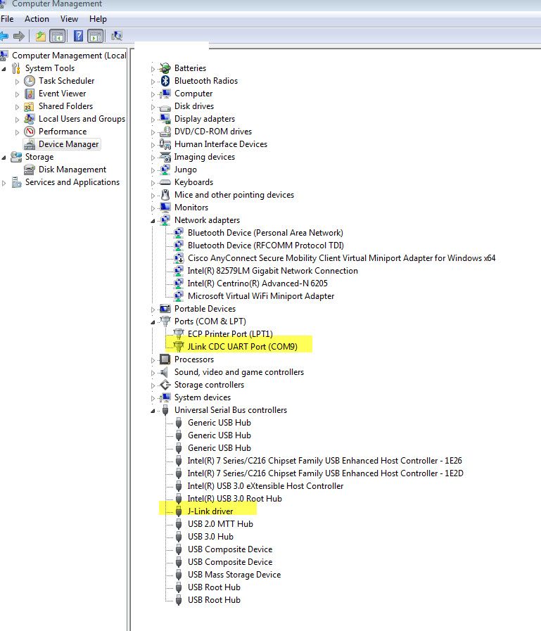

2 JLINK firware
  This is my picture
If you still have question after you change the firmware with the win7, please give me some picture on your side, device manager, and what the board device name on your side, in bootloader or already in the firmware mode.
Besides, you can try it in two win7 systems.
If all have the problem, please also tell me!
Kerry

    Please tell me what the PC OS you are using? Win7 or win10?
   As I know, opensda v2.0 HAVE problems in win10, BUT win7 works.
