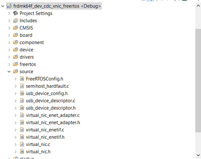

I'm working on project base on K66 processor. I have the latest SDK built with USB and LwIP stack. I need to use LwIP with USB device to connect to PC. I find file: usb_ethernetif_freertos.c but it is for using USB host with LwIP.
Is there any similar file, which connect LwIP with USB device?
3,491 Views
danielchen
The similar demo maybe the virtual NIC,  it is a simple demonstration program based on the MCUXpresso SDK. It is enumerated as a network adapter. Users can access the network by properly configuring this network adapter.

I found two similar project, one of them you mantioned and the second: USB tethering host (RNDIS protocol) implementation for kinetis. So I started to developed my project based on them.
