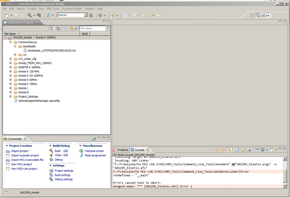

No matter what I've tried I always get the following:
'Building target: AN2295_Kinetis.afx'
'Executing target #3 AN2295_Kinetis.afx'
'Invoking: ARM Linker'
"C:/Freescale/CW MCU v10.3/MCU/ARM_Tools/Command_Line_Tools/mwldarm" @@"AN2295_Kinetis.args" -o "AN2295_Kinetis.afx"
C:/Freescale/CW MCU v10.3/MCU/ARM_Tools/Command_Line_Tools/mwldarm|Linker|Error
>Undefined : "__main"
Thanks, J.

johnnymclean
Hi Zhang, thanks for the clip.
I've posted a screen grab of my CW 10.3 an2295 project. It doesn't have the same files yours does. I'm missing all the _cfg.h files in the CommonSource directory. Also missing the .c and .h files in the bootloader directory.
All I did was import the project and try and build it. Are there additional steps I must do? Also, could you zip up your an2295 project and post it, to see if I can build it successfully?
Thanks, John

johnnymclean
Hi Zhang
I think my first issue is how to import the an2295 project into CW 10.3 or 10.6. "__main" is defined in bootloader.c. It's not getting found and built.
Should I be trying to import this project? Your zip file contains your absolute paths. I thought importing and exporting projects was a way to work around this. (e.g.: make projects portable?)
Thanks, John

Jorge_Gonzalez
Hello Johnny McLean:
When importing the AN2295 project make sure NOT to select the option "Copy projects into workspace":
This is because the project takes its source files from "linked" folders and the links are broken when you select the Copy option. A similar topic is discussed in the next thread:
Re: CW 10.6 Import/Copy to workspace Example Project(s) Issue
Also make sure to disable the file bootloader_asm.s as instructed by colleague Jennie Zhang's video.
Regards!
Jorge Gonzalez

johnnymclean
Thanks Jorge
I should backup a bit. What version of an2295 are you using. I started with the version here:
AN2295 (HC08/S08 Developer's Serial Bootloader) updated for rev. 9.2 - CF V1 (alpha) support added
pavel.kreneks latest beta.
Is there a recommended version, with either CW or DS support?
I had tried your recommendation to not "Copy projects into workspace" but encountered errors like this:
mingw32-make: *** No rule to make target `C:\Temp\!\Kinetis\CommonSource\rs232\rs232.c', needed by `CommonSource/rs232/rs232_c.obj'. Stop.
Really just looking for a set of steps to get the "default" building. Want to get a clean default build before I start modifications for a FRDM K64.
Cheers, John

johnnymclean
I got Pavel Krenek's beta release to build with CodeWarrior 10.6., building the default Kinetis K 100MHz target. I did disable bootloader_asm.s as mentioned above. I had to do a global clean first or encountered errors, but then the build works fine.
Previously I had my workspace on a different drive. Changed the workspace to the default CW 10.6 install directory and stopped having problems.
Will try now to get the AN2295_FRDM_KL25Z_cfg.h based configuration to build.
Thanks everybody, J.
