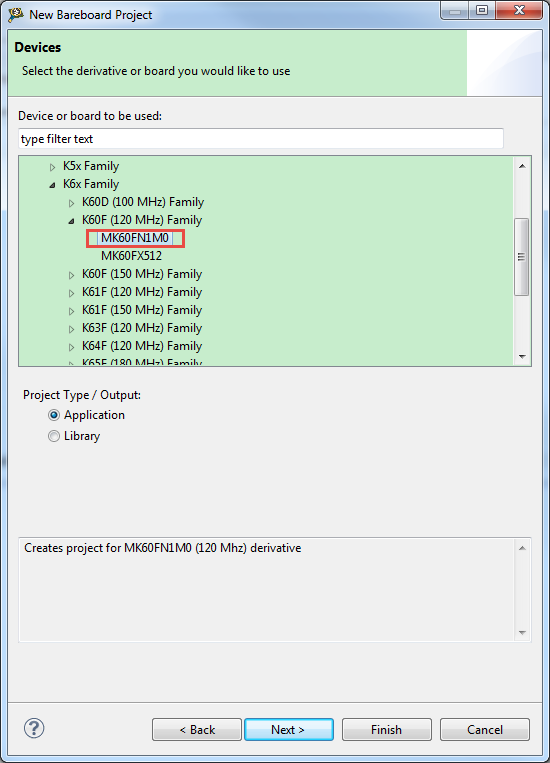

So far, [Pins Tool] does not support K60_120MHz product. Customer could using CodeWarrior for MCU V10.7 Processor Expert tool to do pin muxing as below picture shows:
The CodeWarrior for MCU V10.7 software could be downloaded from here.

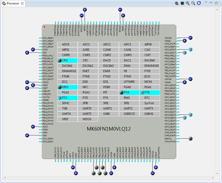

yulistarodubtse
Hi Ma Hui,
my problem is that the processor in question is not on the list of PE available processors. So, I am not sure how did you get to that screen. Did you select some development board? please advise.
Yuli

Hui_Ma
It need to use CodeWarrior for MCU V10.7 software.
During new project creation phase, I select to use this device:
Wish it helps.

yulistarodubtse
Hi Ma Hui,
Your advice does work, thank you. However it seems to me that I have to assign the pins manually. Is it so, or is there some automation on pin muxing available?

Hui_Ma
Using this way, it needs to config used module related processor expert component manually. Then during the code generation phase, the related pin muxing code will be generated.
There without another automatic pin muxing method so far (K60_120MHz product) .
