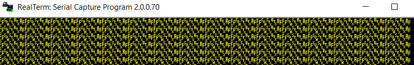

I'm trying to send binary data (bytes with random values) over the virtual com serial port on the FRDM-KL43Z board (from the KL43Z chip to a host PC).  The OpenSDA serial interface seems to do fine with bytes with values correlating to standard ASCII characters, but seems to ignore many byte values that aren't standard characters (they don't get passed on to the host, they just seem to disappear).  Should I expect to be able to transmit binary data over the virtual com connection?

I'm use RealTerm to show the byte data in hex.  I'm using the following subroutine to send 5 bytes repeatedly to try to resolve the problem (I run this about once/0.7 seconds):

At the RealTerm end it displays:
01 02 03 01 02 03 01 02 03 01 02 03 01 02 03 (etc.)
The point of the RealTerm software is to display this kind of serial data accurately, so I'm thinking the problem is more likely in the OpenSDA interface.  However, I'm no serial communication expert, so I could be missing something basic here.

I tested doing this on the FRDM-KL43Z, and using RealTerm (115'200 Baud 8 Bits No parity).
The binary is attached - load with drag and drop onto the OpenSDA disk.
It sends the message that you want to send every 0.7s.
As you an see it doesn't have any problems over OpenSDA so I expect that it is a coding problem.
Mark

Thanks for your help with this.  I ran your code, and it did produce the right results.  So, I put a scope on the KL43Z transmit pin with my code running and indeed found that the missing bytes were NOT being transmitted by the KL43Z to the OpenSDA chip.
So, now I am at a loss as to why the subroutine I included above does not work.  As it is above, only the 1, 2, and 3 get transmitted.  If I change the "2" to "0x6A" I still get the middle three bytes transmitted (0x01, 0x6a, 0x03).  If I change the middle byte ("2") to 0xAF, then only 0x01 and 0x03 get transmitted.  It seems to me that something odd is happening with the LPUART0 that does not appear to be documented, apparently related to the MSB being 1.  Am I missing something obvious here, or is there an anomaly with the MCU?

Ugh!!!   Looks like the problem is with the "char a [5];" in my code.  Changing that to "unsigned char a [5];"  solves the problem.  Not sure why that should matter, but it obviously does.

char a = 0xff; // assume compiler set to default char to signed char (often the case)
LPUART0_DATA = a;
gives (probably)
LPUART0_DAT = 0xffffffff;
unsigned char a = 0xff;
LPUART0_DATA = a;
gives
LPUART0_DAT = 0x000000ff;
Mark

Thanks for your further clarification.  One step further, by writing all those extra 1's to LPUARTx_DATA, bit 13 (FRETSC, Frame Error / Transmit Special Character) gets set, which prevents the data from being sent.  So, the LPUART was just doing what the data sheet indicates it should.
