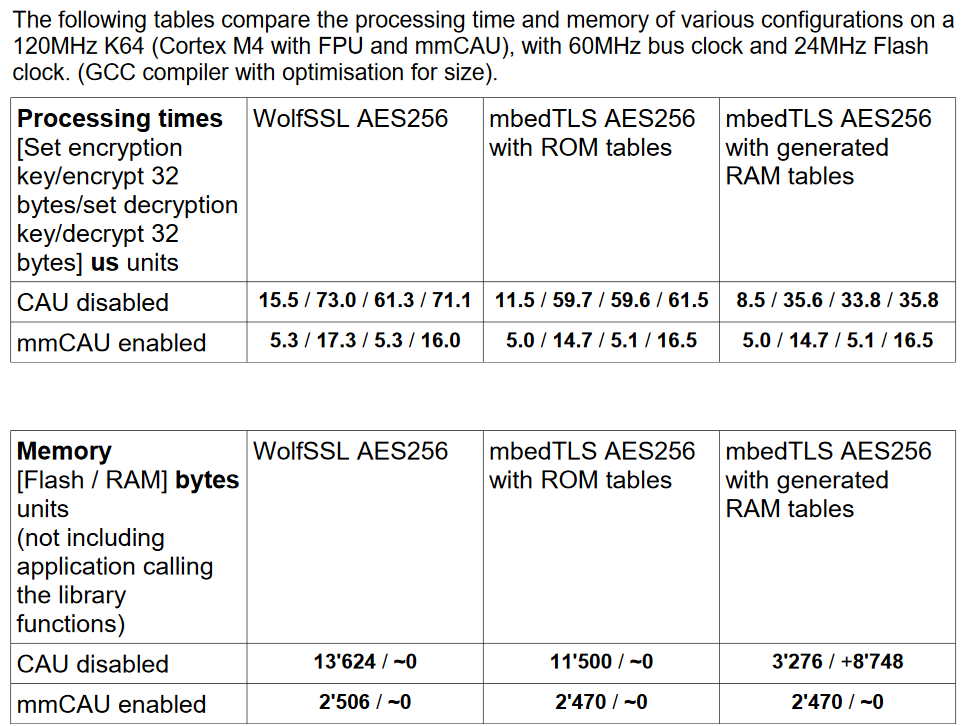

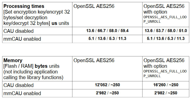

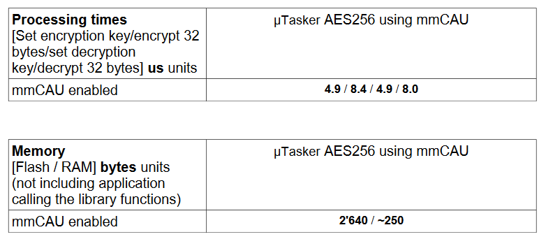

Various libraries are being encapsulated into the uTasker project's Crypto functions which both avoid mistakes (saving project time in many cases) and increase performance in some situations (mainly Flash since the libraries [also CMSIS DSP] in their original form sometimes link in data that is not needed and unnecessarily consume (sometimes large) program space).
Here I have some performance and Flash/RAM comparisons between WolfSSL and mbedTLS (I don't guarantee accuracy and will discussing with the manufacturers about further optimisation possibilities - WolfSSL has a uTasker port in their code which is also being analysed for potential improvements).
It is interesting to note that the mmCAU not only increases performance by a factor of about 4 for encryption and decryption but it can also save almost 10k of Flash space (code and tables)!!
When no mmCAU is available there is a further interesting increase in performance by locating tables in RAM (rather than Flash) and a saving in Flash by generating the content rather than taking it from a const look-up table. This is due to the faster RAM access possible in the K64 but there is of course a trade off between the improved performance and the RAM consumption.
From the tables it is clear to see what range of performance can be expected with different libraries and especially with and without mmCAU.
Where AES256 is needed in designs without mmCAU and there is adequate RAM available (about 8.5k free) it certainly makes sense in relocating tables to SRAM (or enabling the mbedTLS option) since it can double throughput!
Expect very similar results on K8x parts:

For completeness, these are the same comparisons when OpenSSL is used. Is also has a W option to roll out some loops which costs around 4k of Flash and has a performance advantage of about 20% - its tables are fixed in Flash so the mbedTLS option still has the lead in SW implementation:
When mmCAU is available all of the library components can be disabled (removed) and the mmCAU accessed directly.
The uTasker AES256 interface allows this (as stated, when there is an mmCAU available) and the figures below are achieved:
It may be possible to shave off a few more ns by running all code from SRAM but this is tending to the limit and is a further substantial improvement of around 35% on the fastest library option.
Mark
