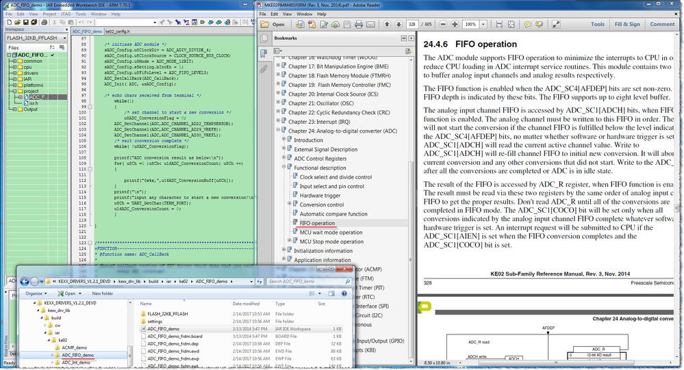

Have you try to use the ADC_FIFO_demo in KEXX_DRIVERS_V1.2.1_DEVD.
Robin
1,885 Views
adam_zhou
Robin, you're right. ADC_FIFO_demo can work for me. Thanks.
