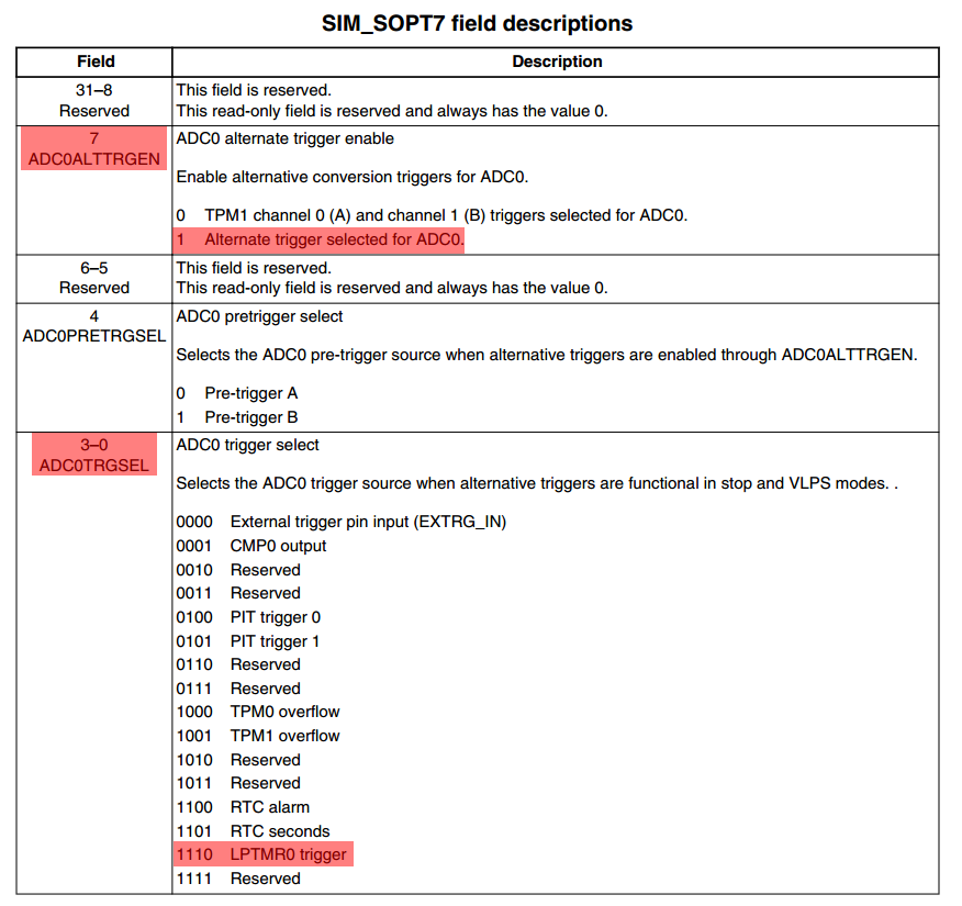

AleGuzman
Out of RESET the default hardware trigger for the ADC points to the TPMx channel trigger. Therefore, you need to select the ADC alternate hardware trigger, this can be done if you write to the SIM_SOPT7 register
SIM_SOPT7 = SIM_SOPT7_ADC0ALTTRGEN_MASK | SIM_SOPT7_ADC0TRGSEL( 14 );
You didn't post the ADC configuration, at the ADC registers you need to be sure that the hardware trigger option is selected. ADCx_SC2 - ADTRG bit
Hope this helps
- Alejandra
