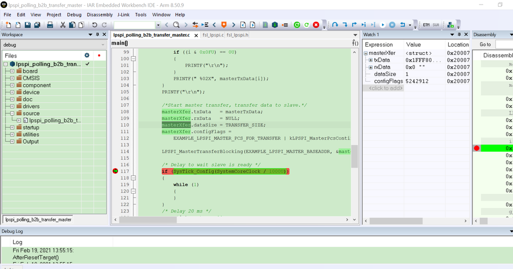

2,994 Views
kerryzhou
Hi CEPL_Dev,
   Do you mean, just when you modify  single byte transfer function in the SDK, you meet the stuck issues?
   Do you test the SDK code:
SDK_2.8.0_TWR-KE18F\boards\twrke18f\driver_examples\lpspi\polling_b2b_transfer\master
  directly? Any issues or not?
  Today, I test our SDK code, just the above master project, I modify the renasfer size to 1 byte, it works Ok:
  You can find, I run over LPSPI_MasterTransferBlocking  :
while (LPSPI_GetTxFifoCount(base) == fifoSize)
BTW, I also test the interrupt code:
SDK_2.8.0_TWR-KE18F\boards\twrke18f\driver_examples\lpspi\interrupt_b2b\master
Even I modify the byte to 1, it also works OK.
So, you can try the SDK code directly.
