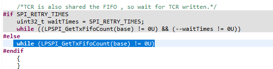

I'm trying to use the LPSPI module of Kinetis MKE18F512VLL16 for making a single byte transfer function. I tried to drive the peripheral with both the CMSIS LPSPI driver as well as the NXP Peripheral SDK Library. Tried example codes for both of the libraries with transfer size set to 1. Every time when I run the code, the data transfer function got stuck in the below mentioned while loop and it's not going forward.

I was having the same issue that you, my LPSPI_MasterTransferNonBlocking function got stucked everytime in that exact place
while (LPSPI_GetTxFifoCount(base) != 0U)
I was debugging and detected that base->TCR had a value of 1 and wasnt changing.
At the end I discovered that it was a problem of my clock configuration because the SPI wasn't running.
If the SPI clock isnt configured correctly it wont run.
At the beginning of my example code I had this:
srcClock_Hz = LPSPI_MASTER_CLK_FREQ;
LPSPI_MasterInit(EXAMPLE_LPSPI_MASTER_BASEADDR, &masterConfig, srcClock_Hz);
And I found that srcClock_Hz got loaded with 0 instead of the real value.
All I did was checking my clock and preescaler config so it is running at correct speed.

   Do you mean, just when you modify  single byte transfer function in the SDK, you meet the stuck issues?
   Do you test the SDK code:
SDK_2.8.0_TWR-KE18F\boards\twrke18f\driver_examples\lpspi\polling_b2b_transfer\master
  directly? Any issues or not?
  Today, I test our SDK code, just the above master project, I modify the renasfer size to 1 byte, it works Ok:
  You can find, I run over LPSPI_MasterTransferBlocking  :
while (LPSPI_GetTxFifoCount(base) == fifoSize)
BTW, I also test the interrupt code:
SDK_2.8.0_TWR-KE18F\boards\twrke18f\driver_examples\lpspi\interrupt_b2b\master
Even I modify the byte to 1, it also works OK.
So, you can try the SDK code directly.
