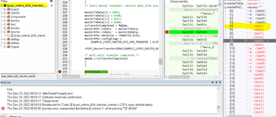

We have tested with by writing Cmd 0x03 and Address 0x00, 0xff, 0x00 in to TDR register.
but getting same issue after that too.
Please find the code before read.
Below is the code to writing into TDR register directly.
The snap after read by calling read api.
Please see the log after read.

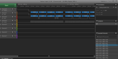

Could you please try out with other examples that don't include eDMA? For example, lpspi_interrupt_b2b_transfer_master and/or lpspi_polling_b2b_transfer_master. This way we could see if it is something to do with the eDMA and how it handles the data and the buffer.
Also, could you please attach the signal behavior with a logic analyzer of the transfer?
Regards, Raul.

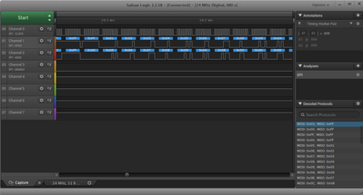

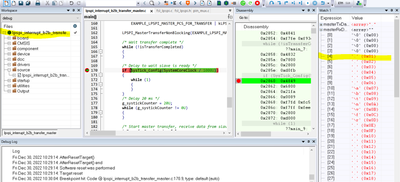

Please find the attached snap for without DMA transmission with PMOD-SF3 and the logic analyzer data.
We have seen same issue.
Shriram Madhavai
