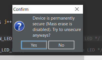

Is there a way in which I can unsecure the KL25z board? When I started the process of debugging, a message saying "Device is secure. Erase to unsecure?" appeared and I don't remember what did I clicked, but now when I try to debug it says "Permanently secure (mass erase is disabled). Try to unsecure anyways?", but despite clicking yes or no, the message keeps showing.

If you did indeed secure your device (flash protection with mass erased), then you cannot unsecure it (as it would be against that concept).
See https://mcuoneclipse.com/2012/11/04/how-not-to-secure-my-microcontroller/ what securing means. Basically the debug probe tries to read from the device but fails and it returns the memory area as secured.
There is a small chance that it is a user error and your device is not secured (see https://mcuoneclipse.com/2012/05/28/device-is-secure/ ) so can you check that indeed you are using the correct device and connection.
Any indication what you did before? Indeed if you programmed a wrong binary with the wrong security bits, then your device is 'bricked' and you need to replace it.

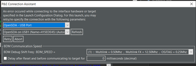

Rafa_Mondragon
After clicking several times in the Try unsecure anyways, this window opens
