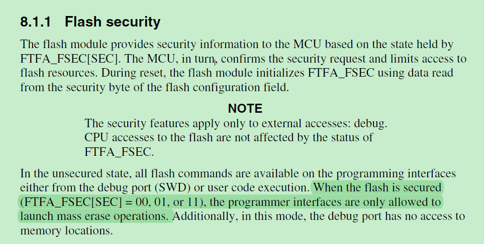

Hello Tiger Lo,
  1. If system already set FSEC to 0xFF (Protection, as I check the manual, it seems ca only erase all & can't erase
      block ), there is any other method can archive let 16 byte flash as data that I can write some run time data as
     parameter even when system power off.
Answer: FSEC is used for security, not the flash protect. You can find more details from the KL03 reference manual:
   You can find, flash security is used for the programmer interfaces, if you use the internal code to operate the flash, it won't be influenced.
   You can use your code erase and write the flash.
  2. Can I set the security bit to disable then do the 16 byte operation when it complete then set the security bit enable ?
 Answer,  security has no relationship with your 16 byte operation, you can use one flash sector as your own data store area.

1. As your opinion security FSEC =0xFF it is irrelevant with flash sector erase/write/read which used internal flash code , right ?
  Yes, it just relevant with the Debug interface.
