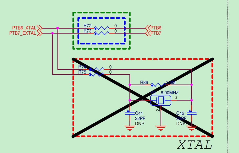

kerryzhou
I find in the TRK-KEA128, it doesn't solder C42 and C41, maybe you also can remove your C42 and C41, then try again.
Kerry

   Before you test the crystal, you need to download my code at first, because it need to enable the internal OSC, then the external crystal can oscillate.
    Besides, I find some version in our TRK-KEA128 is using the external crystal, it is the same crystal in Y1, it is
XTAL 8.00MHZ RSN CERAMIC -- SMT
MURATA
CSTCE8M00G55-R0
I think you can find this crystal, and solder to your board.
Or you can take off one Y1 in another board to one board, then test it again.
Kerry

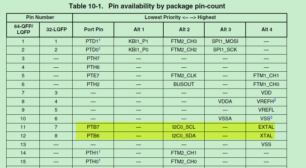

I noticed that the I2C communication is also on these two pins and i doubt that the two pins are still allocated for I2C communication instead of external oscillator because i have no oscillations when i monitored these two signals.
6,359 Views
kerryzhou
Hello Mohammed Aboelnasr,
  Please don't worry, PTB7,PTB6 pin is the EXTAL and XTAL in default, you can find the crystal pin is the highest priority.
  Do you add the 1M feedback resistor? This is very important.
Kerry

kerryzhou
    1. let's talk the hardware about hte OSC
    From the TRK-KEA64 board schematic, you can find this circuit:
You need to solder R74, R75 =0, r86=1M, Y2 8Mhz crystal, C41 and C42.
2. Software
   You need to enable the OSC, then the external OSC circuit can oscillating.
   I already help you create a CW PE project, which is already configured with 8M external crystal, you can download the code to your TRK-KEA64 board.
  Then reset the board, and use the oscilloscope to check the PTB6_XTAL and PTB7_EXTAL, whether it is oscillating?
  If yes, it means your hardware is working, otherwise, you still need to check your osc external circuit.
  Please use my attached project and test it on your side.
After you test it, if you still have problem, please tell me the detail test result on your side.
Kerry

kerryzhou
Hello Mohammed Aboeinasr,
    In my memory, there has some TRK-KEA64 board version don't have the external oscillator.
   So, please check you board at first, do you have the external oscillator for your KEA64?
   You can check the according schematic.
Wish it helps you!
If you still have question, please let me know!
