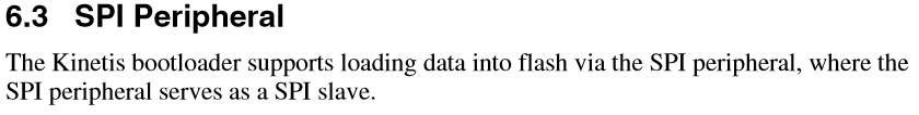

Hello , everyone, Is anyone configure Kinetis Bootloader in Master mode for SPI .. any code please... and where should i implement that.. i am using IAR IDE and FRDM kl25z Board...i hope any one reply..

Hello Mahammad,
You can use the SPI but as slave with the Kinetis Bootloader​, as you can see in its Reference Manual​ it only supports slave mode:
You can take a look into the Demo Application User's Guide​ to get started.
