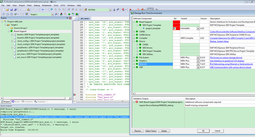

I'm working with MKE04Z8 and with MKV11Z64 and recently I wanted to try Keil to see the compiler diferences.
I cannot start a project because there is no startup code in either of those devices and i downloaded all the DFP needed.
So I'm here stuck at the project creation.
https://www.nxp.com/docs/en/user-guide/MCUXSDKPACKSGSUG.pdf  (5.1) this is not helpful because it implies that a startup file in the dfp exist and its not my case.
So if anyone could give me advice on where to find the package where startup file is?
Or if I need to copy it from another I would ask if there is a "how to add startup file in keil working with nxp" kind of document.
Thanks!

Hi Pau Vilanova,
   After checking with keil and NXP internal side.
  This problem is the known issue, and already reported to the internal side.
   Now, we have the workaround for you:
close the error dialog and select the compiler settings to V6 in project settings, then try to choose the components in the dialog again.
   When you can't find the startup file, close that window, then enter the Manage Run-Time Environment window,
You can try the workaround.

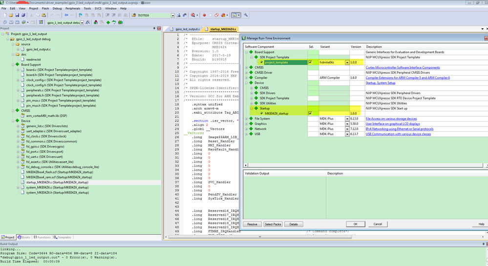

It works with that workaround! I now can generate a new project with startup file and all the dependencies.

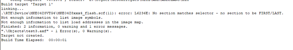

What did you exactly change on MKE04Z8xxx4_flash.scf? I changed to armclang --target=arm-arm-none-eabi -mcpu=cortex-m0plus
But I get the following error:
12,741 Views

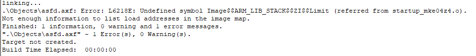

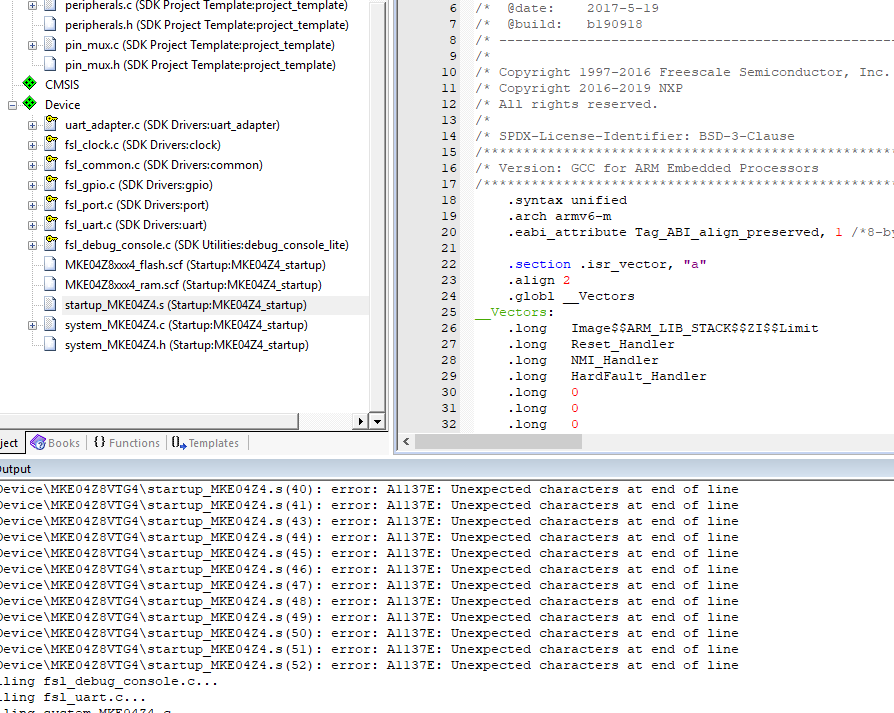

pauvilanova
Also the startup that generates from this workaround is the one intended for gcc and has syntax errors.
And if I copy the startup for arm compiler then I get the error that I posted before:pastedImage_1.png

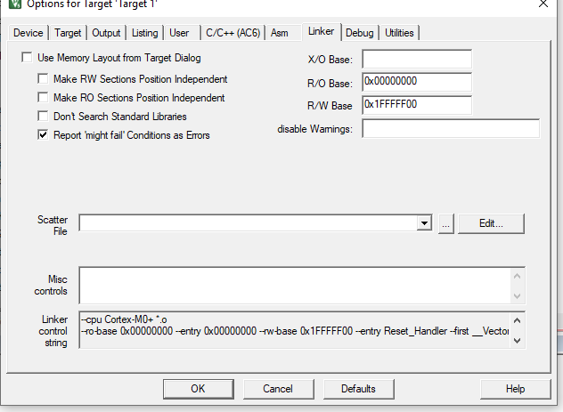

And if I include the scatter file in the linker (which one, ram or flash?)
12,741 Views

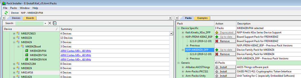

kerryzhou
Hi Pau Vilanova,
  Today, I have installed the newest MDK v5.29, the DFP also use the newest one 12.1.0.
  I have run the SDK2.7.0, no issue:
  So, please tell me how to reproduce your problem?
Waiting for your updated information.
Kerry

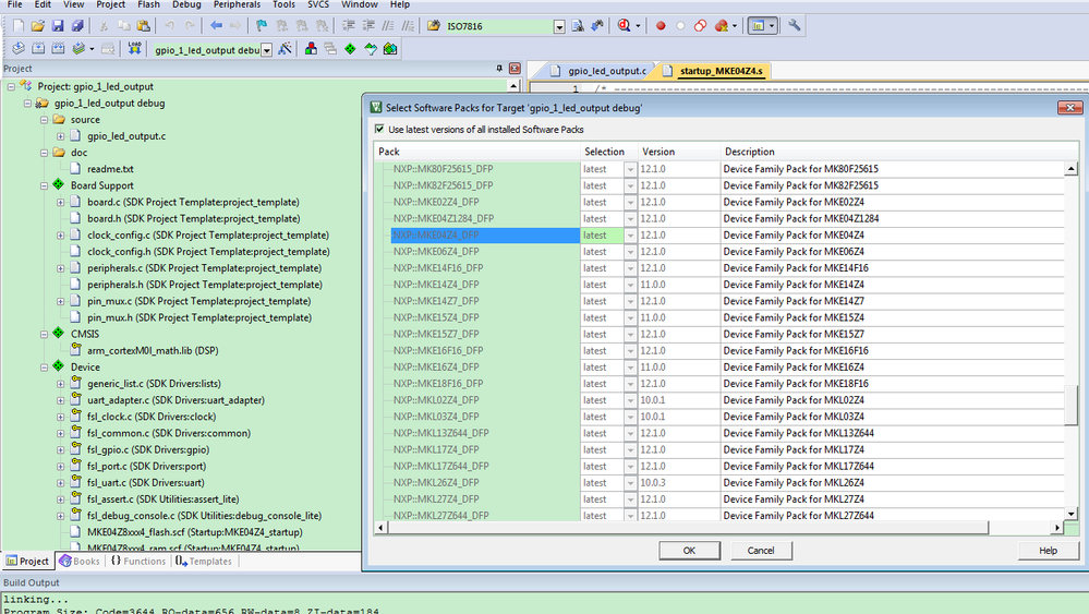

My problem comes when creating a new project using the DFP and the BSP of MKE04Z8. The files that MDK generate from DFP and BSP in all the updates (12.1 11.1 etc) don't compile appart from 2.3. These versions compared from 2.3 lack some files for creating a project with the nxp sdk.

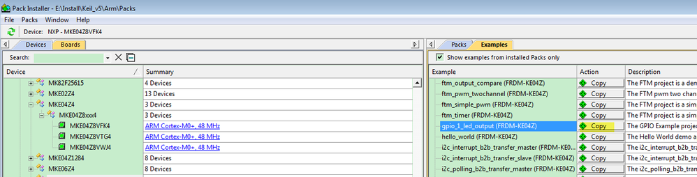

kerryzhou
Hi Pau Vilanova,
   Thanks for your detail information.
    I can reproduce your problem now when I create a new project.
But if I copy one pack examples
Then open the example project, we can find this project contains the startup item:
So, I think, the MDK pack really have problems.
I will report it to the MDK side.
You also can use the example project, then modify it on that project.
Any reply from the MDK side, I will also let you know.
Kerry

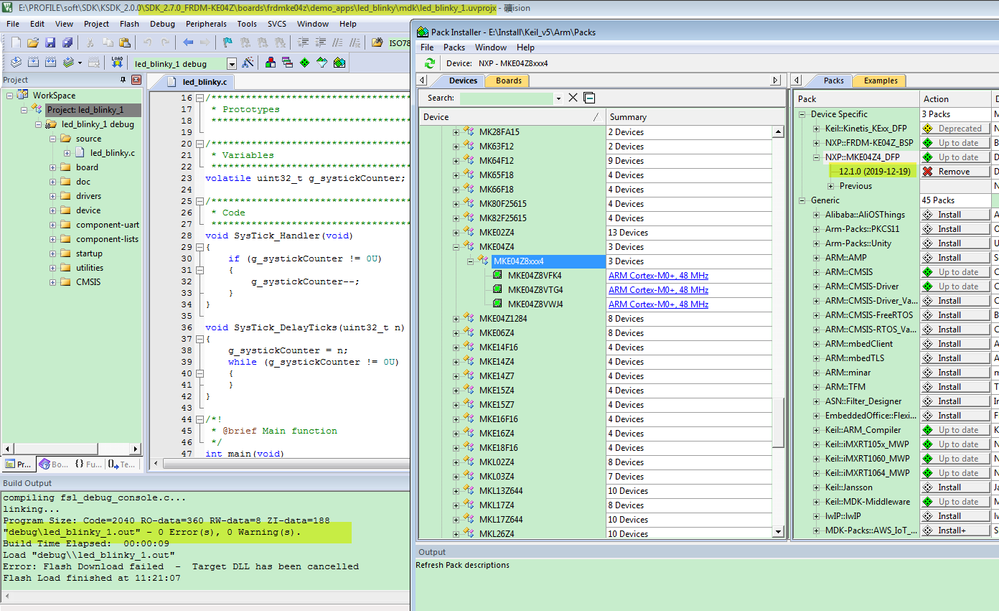

12,741 Views
kerryzhou
GENERAL: HOW TO COPY A µVISION PROJECT
Kerry
12,741 Views

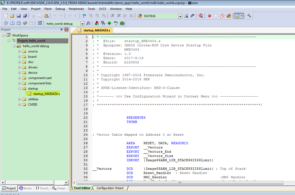

pauvilanova
Well, it appears that the SDK 2.7 has a diferent start-up assembly code than your version which is 2.5... at least in \SDK_2.7.0_FRDM-KE04Z\devices\MKE04Z4\arm  they both compile ok which I don't clearly understand.
Can you check that please??
And it's not just the startup file that is missing in the DFP of MDK, there are a lot of missing dependencies with it, can you check also that?
2.7:
2.5:
12,741 Views

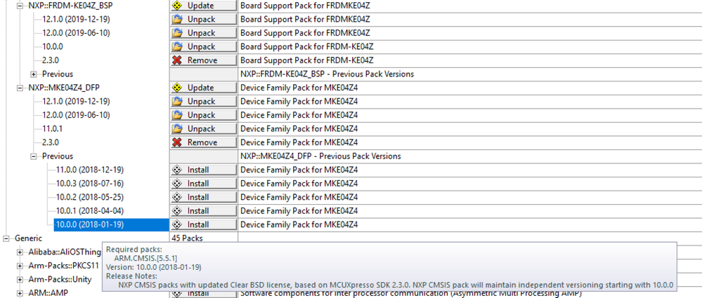

pauvilanova
Hi Kerry,
It seems that correct files and a startup can be generated if I use the 2.3 version. Installing newer updates seems that there are a lot of files and dependencies missing. And upper versions start at 10.0.
why 10.0?
There is no info out there about this updates at least that I know of.
Did NXP messed up when updating?
Could you check if I'm wrong please?
12,741 Views
kerryzhou
Hi Pau Vilanova,
   Yes, the new SDK2.7.0 already update the .s files.
   You said both SDK2.7.0 and SDK2.5 compile works OK, which DFP you are using now? Do you use the newest 12.1.0? You can remove all the other low DFP version.
   My MDK IDE is a little old, and it can't update the DFP now, I need to update the newest IDE and test the newest DFP.  Normally, NXP recommend the customer use the newest SDK and the DFP.
   You said: Installing newer updates seems that there are a lot of files and dependencies missing.
   Do you use the DFP 12.1.0? Could you also please give me your error picture?
Kerry

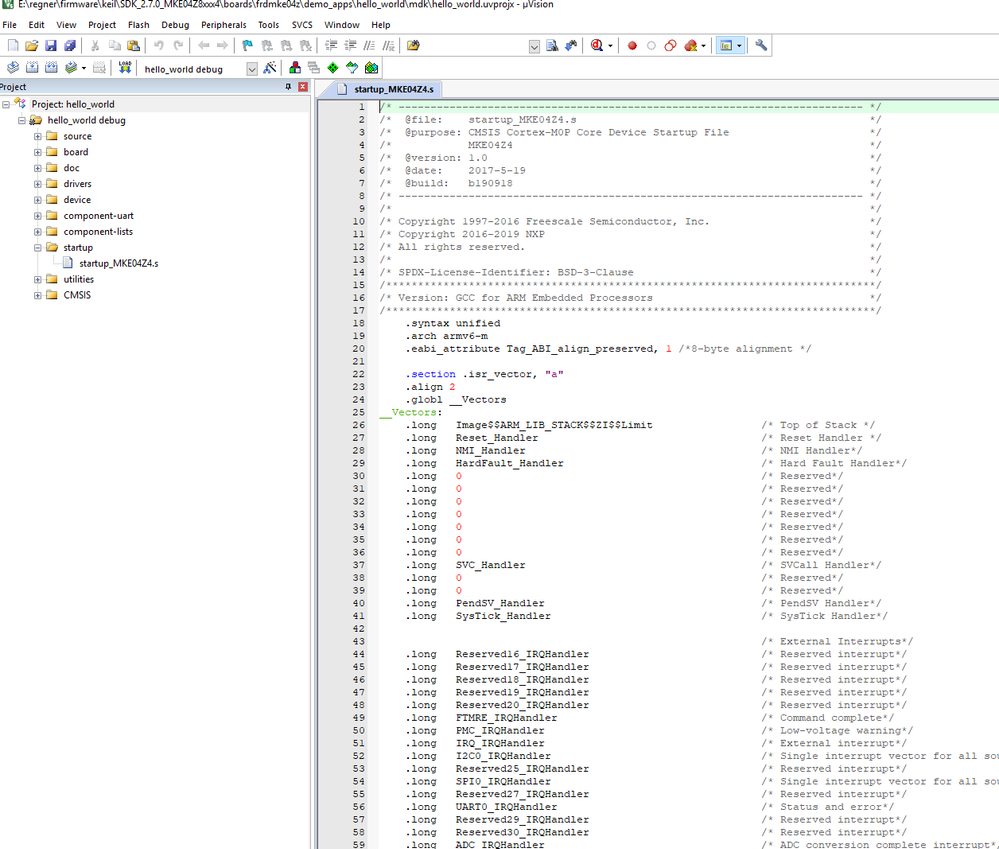

kerryzhou
Hi Pau Vilanova ,
    What's the MDK version you are using?
    Do you update your MDK IDE to the newest one?

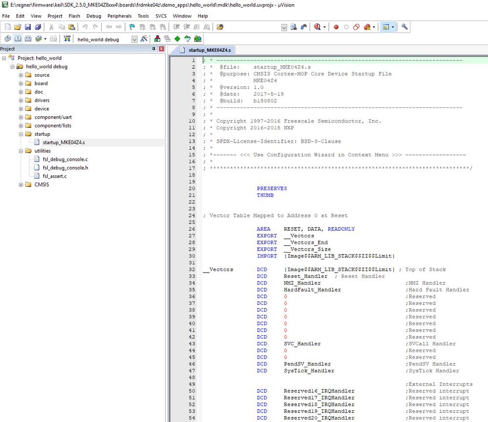

    About the MKE04Z8 and MKV11Z64 startup code, you can use the SDK related .s code, eg startup_MKE04Z4.s.
Take KE04 SDK as an example, the .s file for MDK can be found in folder:
  You can download the SDK code from this link:
  Welcome | MCUXpresso SDK Builder
   Please note, the SDK2.7.0 need the MDK version is:
MDK-Arm Microcontroller Development Kit (Keil)® 5.29
Wish it helps you!
If you still have questions about it, please kindly let me know.
Kerry
12,741 Views
pauvilanova
Hi Kerry,
I'm using 5.29, all updated.
I know how to find startup in other projects, the thing is that I don't know how to import to keil and build a new project with it.
Also I think that the startup file you pointed is for the gcc compiler and not for the Keil arm compiler.
So if you told me how to get a startup file that means the device family pack for MDK does not include one??
12,741 Views
kerryzhou
Hi Pau Vilanova,
  You don't need to use the MDK pack .s, you can just use the SDK .s, and copy it to your MDK project, then add it to your MDK workspace project, just like the SDK keil project:
   The .s file which I told you is what the SDK keil project using now.
Wish it helps you!
Kerry
