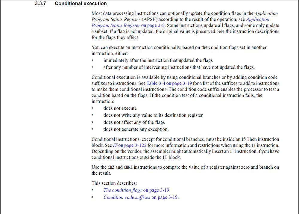

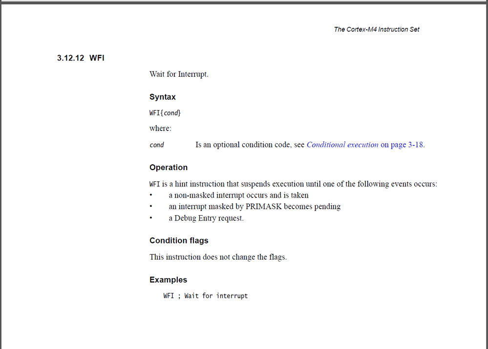

Thanks for the clarification! Kinetis devices execute the "WFI" instruction to enter low power modes, but WFI is a conditional instruction, so you may define a macro for this instruction with a condition, and change the condition to FAIL in the ISR which happens right before this intruction, so that this instruction does not execute at all in such case. Please kindly refer to the following for more details.

sorry not to be more specific.
Yes I want to disable sleep mode in ISR which can occur just before sleep mode entry instruction. I think only HW based sleep mode disable can handle this.
