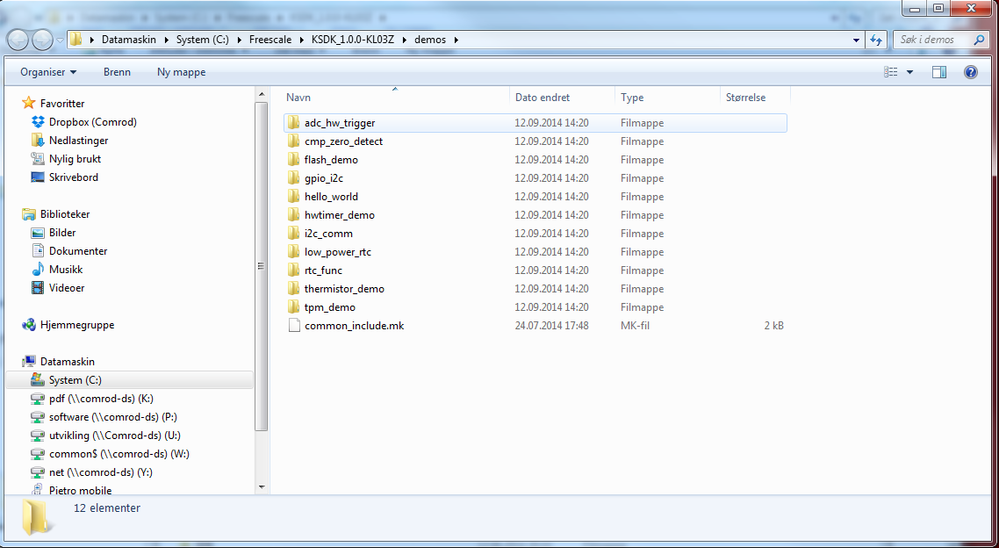

pietrodicastri
Senior Contributor II
Hi Kan_Li
Thank You for the support.
I have this situation on my demos directory. What's wrong?
I have googled for \lwip_httpserver_demo and I find a reference to the work of Adam Dunkle. Is this the stack used
for the Kinetis???
Thank You

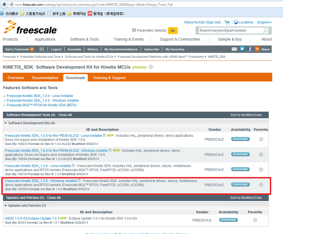

Kan_Li
Hi Pietro di Castri,
Seems you have installed the special version for KL03Z, actually there is no ethernet module on that chip, so no demo in that SDK, you should download the following version instead.
Hope that helps,
