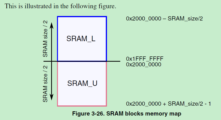

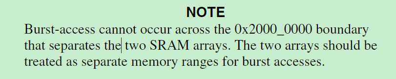

Hui_Ma
Hi Ethan,
Sorry for the later reply.
Yes, if you are using the FS USB module, you can place BDT/buffer at external DDR SDRAM or internal SRAM.
Please pay attention to the internal SRAM, which is split into two logical arrays that are 32-bit wide
There with a Note about burst access SRAM memory:
If possible, please place the BDT/Buffer at the same SRAM logic array.

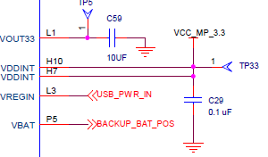

Could you measure the VOUT33 pin voltage when Linux PC doesn't successfully enumerate K70 device vs. Linux PC successfully enumerate K70 device?
If there exists the voltage difference?
We want to make sure the K70 VREG module works in RUN mode and USB module doesn't work in suspend state.
Mike
10,259件の閲覧回数

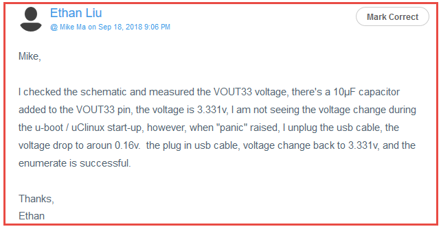

ethanliu
Mike,
I checked the schematic and measured the VOUT33 voltage, there's a 10µF capacitor added to the VOUT33 pin, the voltage is 3.331v, I am not seeing the voltage change during the u-boot / uClinux start-up, however, when "panic" raised, I unplug the usb cable, the voltage drop to aroun 0.16v.  the plug in usb cable, voltage change back to 3.331v, and the enumerate is successful.
Ethan

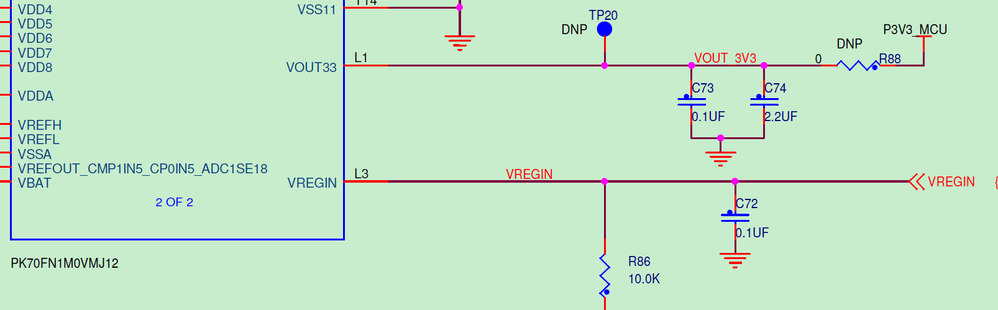

10,259件の閲覧回数

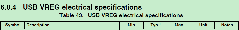

Hui_Ma
Hi Ethan,
I checked the VOUT33 output capacitor with below value at K70 datasheet:
So, I think you can refer TWR-K70 board to replace a 2.2uF capacitor with VOUT33 pin:
Your K70 board as USB device is self-powered device, right?
When "panic" raised, the VOUT33 with voltage drop, which indicate the VREGIN pin with Power off/on processing?
Mike
10,259件の閲覧回数
ethanliu
Mike,
thank you.
Yes, my K70 board usb device is self-powered.
what I was trying to say is that there's no change for the VOUT33 volt no matter "panic" raised or not, it's around 3.331v,  the VOUT33 volt only change if I unplug the usb cable.
I tried replace 10uF capacitor with 2.2uF, but it does the same,  although the VOUT33 volt change to around 3.26v.
below is part of signals of my K70 board:  the USB_PWR_IN is connected directly to VBUS ( USB VDD). we don't use BACKUP_BAT_POS usually.   I haven't added any code related to USB regulator, Is there any configuration needed  for the USB regulator?
Ethan

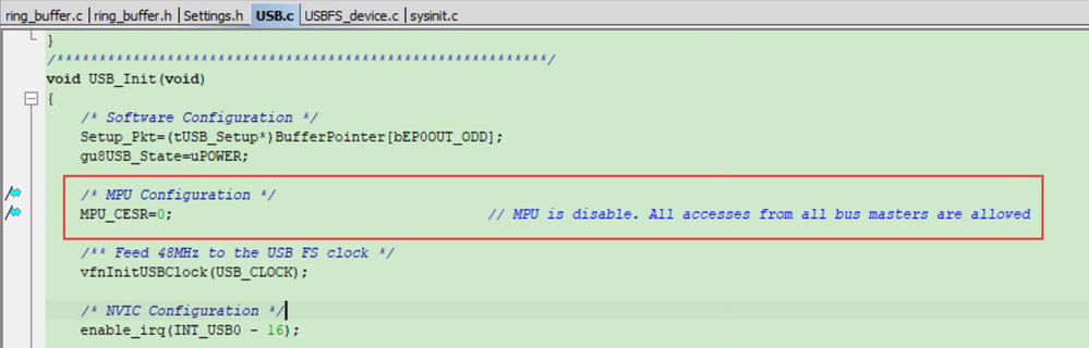

Hui_Ma
Hi Ethan,
Thank you for the info.
Please check the MPU_CESR register value.
I checked K70 bare metal USB device project, which during USB initialization code will close the MPU (MPU is enabled default).
Could you try to disable the MPU after ucLinux boot up?
I know ucLinux need MPU enabled, while you could try if MPU could affect.
