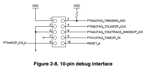

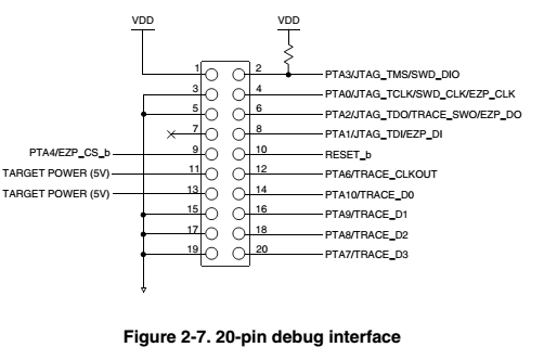

In the KQRUG in the section 2.1.5.3 Debug interface are shown the hardware considerations for the JTAG and SWD interfaces.
There can be seen that the data line needs a pull up resistor. Also, it is needed a pull up resistor and a ~100 nF capacitor in the reset line, this is not shown in those schematics.
Please confirm that you have that hardware in your board.

My JTAG was originally routed the wrong way but I fixed it in my cable. My configuration is as shown in your figure 2-8 besides pin 9 which is grounded on the connector. The MCU pin EZP_CS_B is floating. I have a 10k pull-up on both JTAG_TMS and reset_b. I have also added a 100n capacitor to ground. Still the same problem.

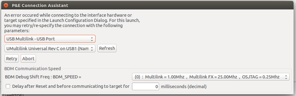

I have also tried to use the JTAG tool from the KDS on Linux. The debugger detects the tool but debugging fails with the following message:

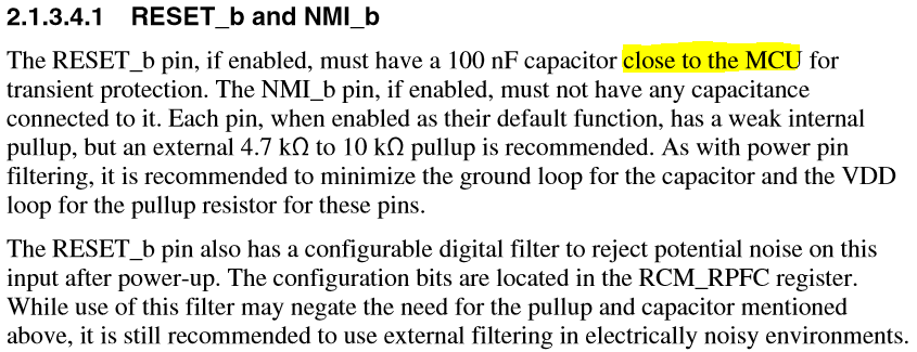

Please be sure that the cable is ~15 cm (or shorter). Also in the KQRUG, you can see that the NMI_b pin needs a pull up resistor and the RESET_b capacitor needs to be as closer to the MCU as possible.

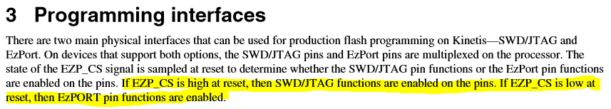

Also, in the AN4835​ in the section 3. Programming interfaces is mentioned that the EZP_CS pin (pin 9 in the 10-pin debug interface) must be in high to enable the SWD/JTAG functions. Please add a pull up resistor.​
