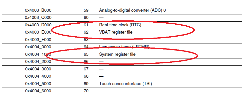

jingpan
please search "register file" in reference manual.
5,599 Views
dusek_martin
I'm sorry, I didn't understand what you mean by register file in your previous post.
So great, there will be no problem in implementing what I want. Thanks

jingpan
Hi Martin,
Flashloader hasn't run_bootloader() function. But in fact, if you look into its final code bootloader_user_entry(), it only reset the chip. So, if you want to jump back to bootloader, just call NVIC_SystemReset().
After reset, the bootloader will wait for peripheral connection. The default time is 5000ms which is defined in bootloader_config.h. The macro name is BL_DEFAULT_PERIPHERAL_DETECT_TIMEOUT.
If you want to keep some value when system reset, you can put the value in sytem register file. It reset by POR only. Not all of kinetis device has this register file. But most of them have. If the chip you're using hasn't it, you have to save data into flash or external memory.
