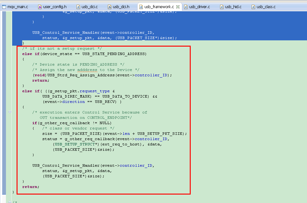

Hi ,
Are you referring to the PE example in "C:\Freescale\Freescale USB Stack v4.1.1\ProcessorExpert\Examples\Device\HID\USB_HID_MOUSE_DEVICE_K60_PEx"? Actually when "event.setup = FALSE", the "static void USB_Control_Service(PTR_USB_DEV_EVENT_STRUCT event)" handles as below:
I think that is where the stack handles the following OUT transaction.

izmile
Hello Kan,
Thanks for your reply.
Yes, you are right that the OUT transaction will be handled by the second "else if" block that you highlighted. However, note that the second "else if" condition will be true immediately. The processor will call the g_other_req_callback even if the host did not send the OUT packet. I was expecting some sort of blocking (or interrupt mechanism) that would wait unit the OUT packet has reached the processor.
I am sure, I am missing something in the code.. I would be happy if someone points it out.
