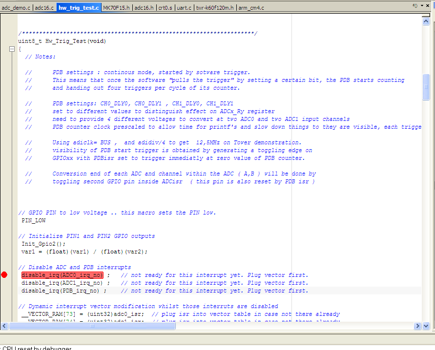

I've been modifying the ADC demo for the K60 tower board and have run into an issue with simple floating point math.  Integer math works fine but any floating point math causes the debugger to jump to the default ISR.  I can start a new project in CW with either the GNU or Freescale compiler and the math works fine.
static float var1 = 19990;
static float var2 = 65535;
uint8_t Hw_Trig_Test(void)
var1 = (float)(var1) / (float)(var2);
The above math crashes with the adc demo but works fine with new projects.  Thoughts?

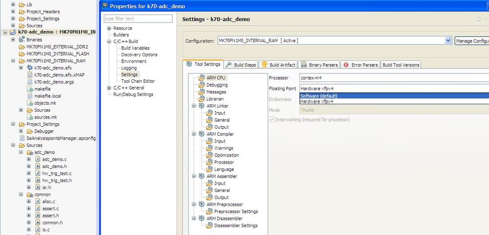

In CodeWarrior, you should do a setting as picture. Right click project then select properties -> Setting -> ARM CPU. Then change floating point from "Hardware vfpv4" to "software". Then you can do floating point operation as you need. This issue is caused by porting IAR code to CodeWarrior. IAR initial code is not including FPU module.
