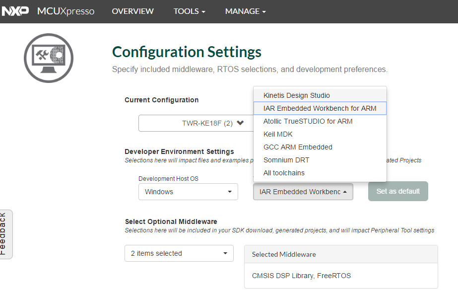

I noticed that the microcontrollers from the KE1xF family cannot be programmed with Kinetis IDE / Processor Expert. Are you planning to support this microcontroller anytime soon?

Hi, KE1xF should be able to support KDS. Please download the latest SDK package from NXP website to try.
https://mcuxpresso.nxp.com/en/configuration-settings

Hi, thank you for your answer. I did not know about the KDS v.2.
Are you also planning to provide support to this microcontroller in Processor Expert?

Hi,Bianca
         No, PE will not be supported on SDK2.0 any more according to current NPI planning. New Kinetis expert(pin tool,clock tool) will replace it.

I have used the KDS tools, and have built a project, I can use PE with the the KDS tools based on KE04.
Hope it can help you

I attach the screenshot of PE based on KE04 and KDS tools.
