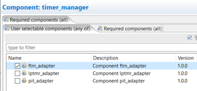

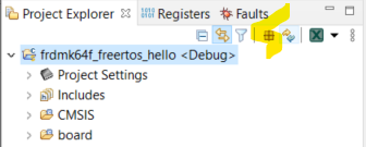

I'm using the SDK v2.11.0 from the K64-EVK board and I add that library with these steps.
Select your project and then select the icon in the yellow mark.
Then select the Software Component.
Type timer or manager and this will show, you can select direct or you can manage how this library works.
Documentation [MCUXpresso SDK API Reference Manual: Manager (nxp.com)]

Thanks, I was able to add the library, I just couldn't find the documentation.  NXP might want to put a link to the documentation on the SDK home page (SDK).

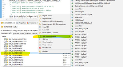

Pavel_Hernandez
Could you try to update the SDK and then search if the document is here?
Pavel
5,891 Views
JBM
Contributor V
Thanks - I didn't know that was there.  The only thing it shows, is two PDFs, Release notes and Getting started.
