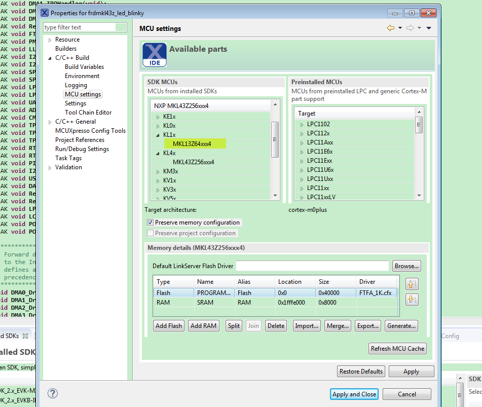

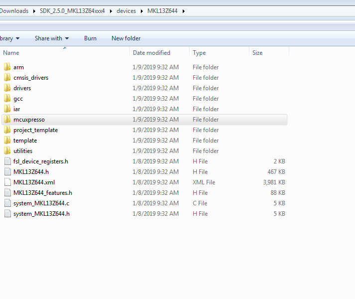

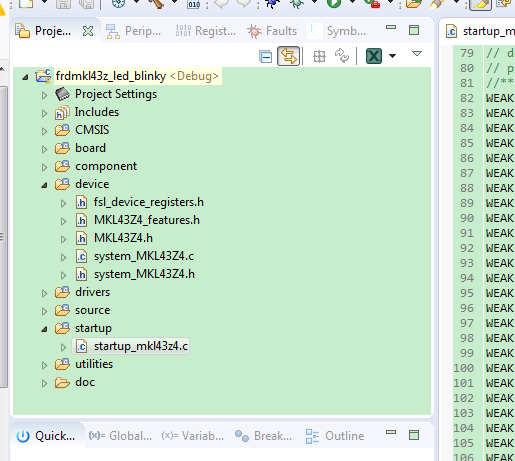

kerryzhou
Hi Evan Griffh,
    I suggest you use the MCUXpresso IDE instead of the KDS.
   Then you can open the SDK for KL43, and modify the according KL43 source code to KL13.
1. startup file change to KL13, you can find it from folder:
SDK_2.5.0_MKL13Z64xxx4\devices\MKL13Z644\mcuxpresso
2. Change the project device folder files, which can be found in folder :
3. Change the drivers folder with :SDK_2.5.0_MKL13Z64xxx4\devices\MKL13Z644\drivers
4. Change the MCU to your KL13 chip:
Please try it on your side.
If you still have problems about it, please kindly let me know.
Kerry
