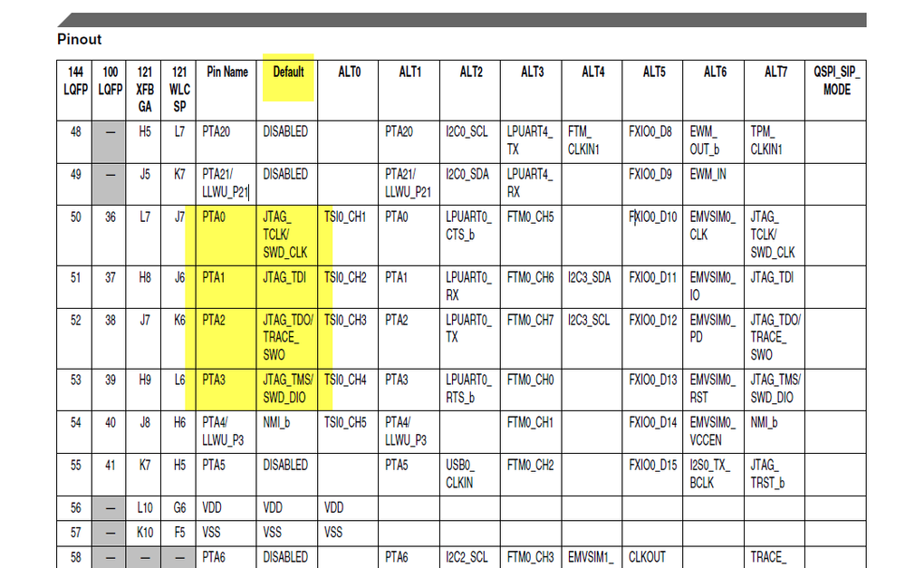

I'm going to use full JTAG interface on K82 e.g A0-A3 and A5 pins.
Should those pins be really configured as JTAG pins by using ConfigTools or possible to leave those pins as non configured for have low power consumption when MCU in low power mode ?

Hi Eugene Hiihtaja,
    You don't need to configure the JTAG pins as the JTAG function, these pins are in default configured as the JTAG after power on or reset, please check this information:
   So, don't worry, just use it.

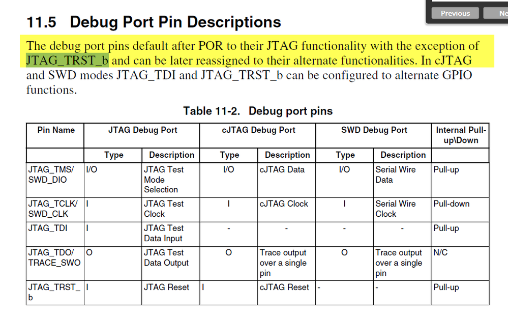

But what means float state of pin what recommended from low power point of view.
At some point we disable JTAG interfaces via .FlasConfig and might have sense to set those pins to some state as well.
What about PTA5 pin ? By default it is disabled and for be used as JTAG_TRST_b it should be configured.

   Float means you didn't connect anything on this pin in the external side.
   About PTA5, yes, this pin is really special, you really need to enable it in the code, please check these description:
So, maybe you need to use the normal JTAG to download the code which configure the JTAG_TRST_b pin to it's function, then you can use the JTAG_TRST function again.
