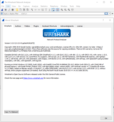

The problem persist. I can't run KPAA (version 2.0.2.1) it complains that I don't have Wireshark installed (3.2.0) eventhough I have it

I download older version of KPAA  2.0.2.1 and Wireshark 3.2.16, but now I can't start KPAA because of error:
"Wireshark is not detected on your PC"

nxf56274
Please refer this link.
