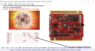

The uTasker project includes a Kinetis simulator that will emulate all peripherals and make testing and verification simple (without needing HW) and below is a screen shot of it running, with the mouse hovered over PTC3 so that it displays is possible functions and programmed function, as well as showing the signal that the FlexTimer is generating on this particular output - confirming that its frequency is accurate and the 50% MSR was achieved fairly well (with a /16 prescaler).
