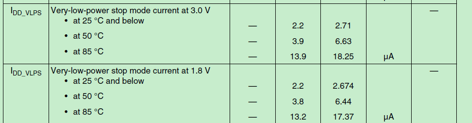

It does not matter if its more current, my target is 3uA per processor, but i can handle 10uA per processor really, (20uA total)...
I think I can run the KL03 in VLPS with LPO and use the LPTMR to wake up and get around 6uA? This wont require any reset logic to be handled, it can just stop and wake up and continue?
KL27 looks ok to run in LLS mode with RTC and external 32Khz xtal? Should be under 5uA?
This will take my total power to around 10uA which is fine, I can handle up to 20uA to meet the project requirements.

1. KL03 VLPS
yes, you use the LPTMR to wake up, the power consumption will below 6uA, I have test it on our FRDM-KL03 board with KSDK2.0.
After VLPS wake up, the code will continue to work below the point where enter the VLPS, it is not reset.
2. KL27 in LLS mode
Yes, it also can under 5uA.
You can use it, now the low power mode is determined on your side.
