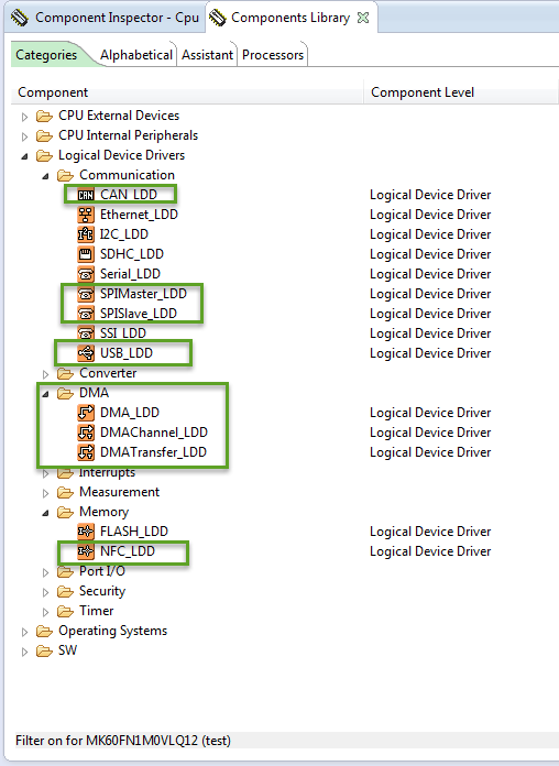

henrynguyen
Hi Hui_Ma,
i am open to IDE (CW or KDS) whichever offers supports for me in term of example codes for SPI, DMA, USB, CAN, NFC on the TWR-K60F120M board so that i can be up to speed fast to evaluate.  can you please confirm if CW can support these interfaces with example codes?
Thank you,
Henry
1,550 Views
Hui_Ma
Please check Processor Expert tool (CodeWarrior V10.7) provided Logical Device Drivers for CAN, SPI, USB, DMA and NFC:
Wish it helps.
