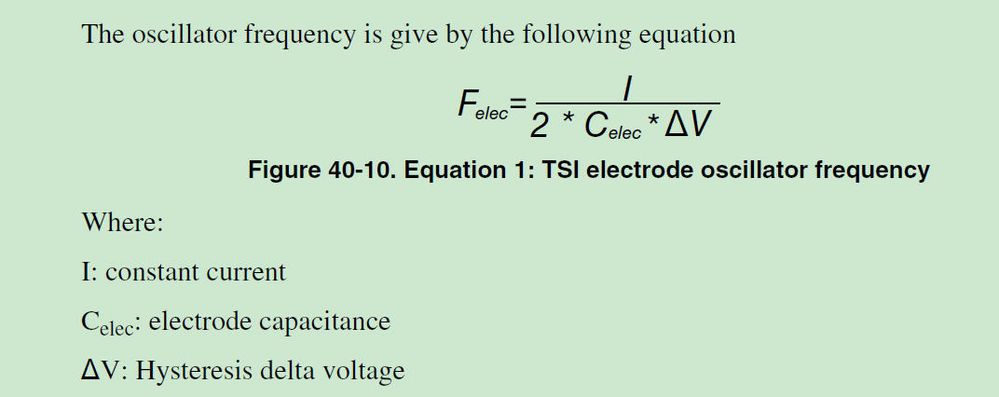

I'd like to know the frequency range of the signal at an electrode when I'm using the TSI module. I have not seen that in any datasheet. Does any body know that?

Hi Sandro,
The reference clock is used to measure the electrode oscillator by ticking a 16-bit counter. The reference oscillator frequency depends on the current source setting.
The same way, the electrode frequency range also according to following equation:
Wish it helps.

sandroaufdermau
Thank you very much. Exactly what I searched for...
