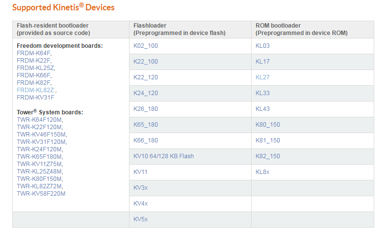

I am working with the Kinetis KL Microcontroller. For other controllers (such as the KL03) there is some information in the reference manual about the bootloader and how to jump to it from user application. But I have not found such information for the KL14 microcontroller. Is this feature (jump to bootloader) supported? Are there any differences with the bootloader of the Kinetis KL03? Where can I find this information?
Thank you very much in advance.
Tags (2)
1,418 Views
Jonathan_Iglesias
Dear Alejandro Navarro,
The KL14 is not supported.
For more information check this link.
please let me know if you have more questions.
Best Regards
