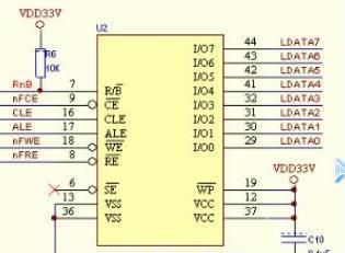

I can not find the documentation for the connection diagram via NFC and 8-bit NAND Flash chip.
How to connect the data bus ?  In 8-bit mode used NFC_D0-NFC_D7 or NFC_D8-NFC_D15?
NFC_D0 - NAND_D0
NFC_D7 - NAND_D7
or
NFC_D8 - NAND_D0
NFC_D15 - NAND_D7

Hi, Andrey
Sorry, I think as Flexbus by mistake.You should connect low data bus. Please reference attached picture.8-bit NFC.jpg

andreyvarsegov
Thank you for quick answer, but you sure to FB_D0 - FB_D7 ? May be NFC_DATA0 - NFC_DATA7, because at TWR-K70F120M-SCH.pdf  16-bit NAND Flash connected to NFC_DATA0-DATA15, not to FB_D0-D15.

Hi Andrey,
In NFC 8-bit mode, please connect  NFC_D0-NFC_D7 with external 8-bit NAND Flash device.

Hi Hui_Ma,
Thank you very match!
