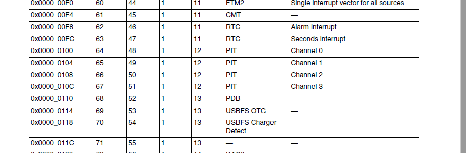

kerryzhou
Hi Kishore Bolisetti,
     What do you mean?  Do you still want to use another PIT channel timer interrupt?
From the K65 interrupt vector assignments table, you can know that different PIT channel have different vector
So, you can use other PIT channel interrupt.
But the same interrupt when happens, and didn't exit the ongoing interrupt handler, it can't generate another same interrupt.
 So, I think you can try another channel PIT interrupt.
Wish it helps you!
