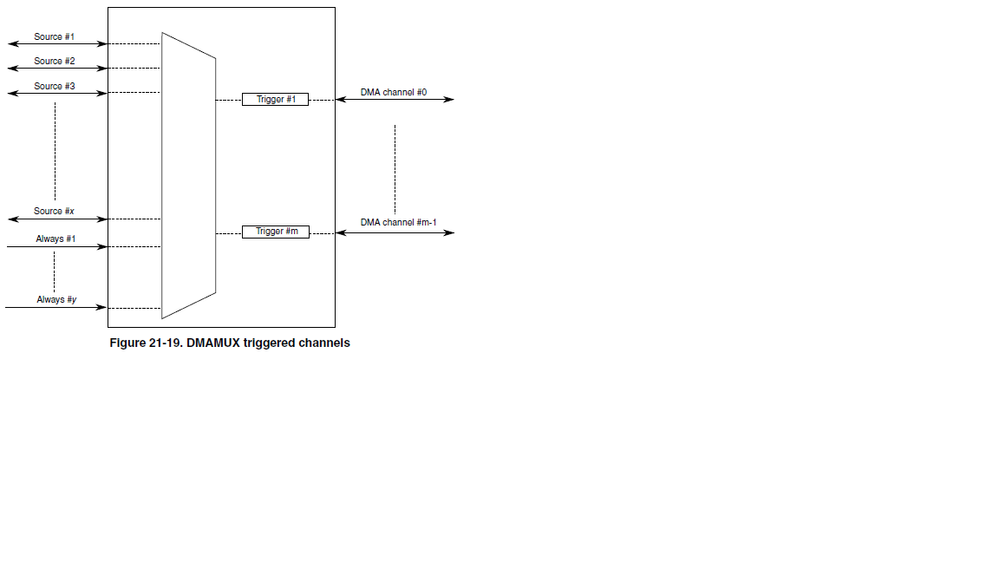

I am sorry for the delay. Regarding the GPIO toggling based on  DMA plus PIT, You have to use DMA channel0 if you use PIT0 to trigger, use DMA channel1 if you use PIT1. I attach the fig here.
For DGPIO configuration,   you have to set the PORTx_PCRy as GPIO function and set the IRQC bits as 3(DMA request on either edge.). For example, if you use PIT0,  you have to use DMA channel0. Set the source bits of DMAMUX_CHCFG0 as 49(PORTA), 50(PORTB), 51 (PORTC)..., configure PIT0 registers and DMA registers, it is okay.

Thanks! To save other customers trouble, please consider updating the manual adding links in the PDF to the mentioned chapter, or at a very minimum say "Refer to chip configuration details chapter above"... I was looking for a separate document (as have other customers asking this question on this forum).
Can you answer questions 4 and 5 above?
Also, another apparent documentation error:
6) In reference manual 21.4.1 DMA channels with periodic triggering capability: PIT 1 is shown connected to DMA trigger 0. In reality, PIT 0 is connected to DMA trigger 0, right? Here's the erroneous diagram (also repeated in the text)K64F_wrong_trigger_connections.png
