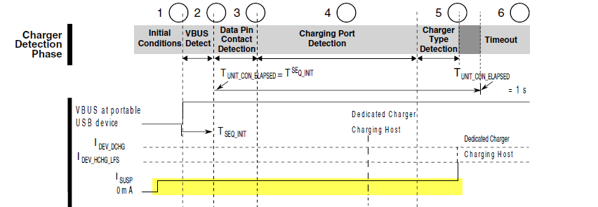

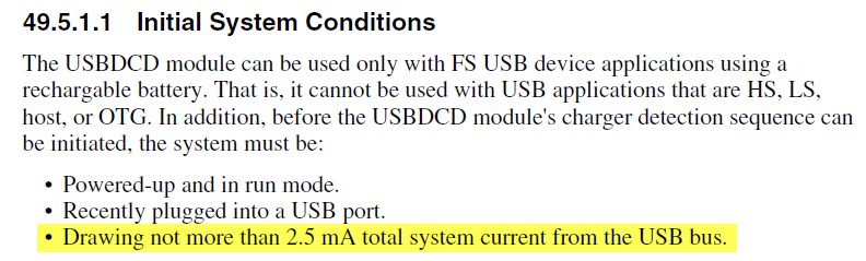

The USBDCD is intended to be used with rechargeable battery powered systems and your case does not match the target application. Since you do not have a dedicated battery charging IC to regulate the power drawn from VBUS, then your system will not meet the maximum 2.5 mA initial condition:
This condition should also be maintained during charging port detection:
