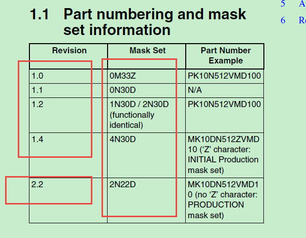

I have checked and it is correct. My chip is marked as 0M33Z and it does not have RCM register at address 0x4007F000, it has only MC register at address 0x4007E000. When I used memory map according to this document http://cache.freescale.com/files/32bit/doc/app_note/AN4445.pdf  the program runs correctly.

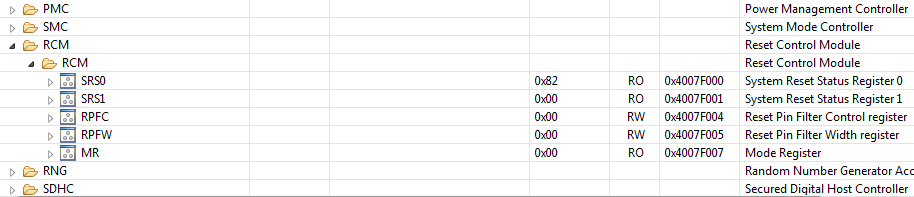

I see.  I assumed your picture of 8/21 3:21P was of a debug session using this chip, showing SRS0 contents of 0x82 for a power-up indication of 'low voltage reset' and 'power on reset'.
Yes, we all should have looked down this thread:
https://community.nxp.com/message/529457#comment-529457
Your chip doesn't HAVE that SRS0 register, hence the fault.

kerryzhou
Hi Lukasz,
    Thank you for your more details, yes, TWR-K60N512 board is using 1.x k60 chip, so please use the according code from the attachment, don't use 2.x sample code, eg, TWR-K60D100 is using 2.x chip.

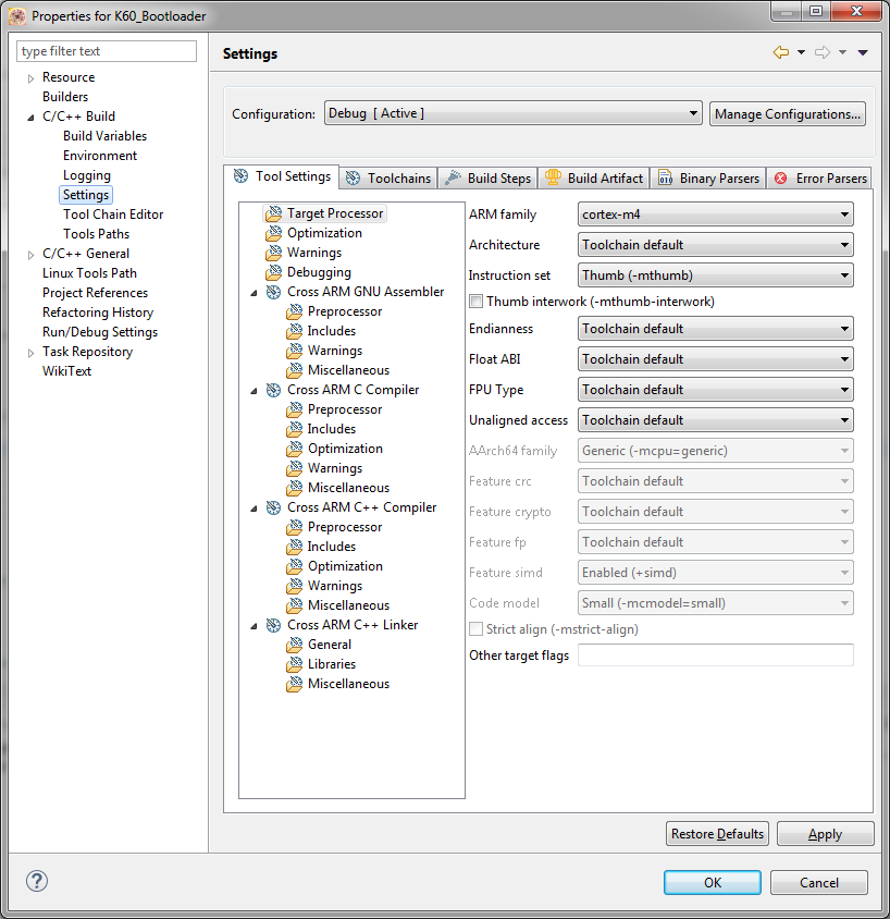

I use Kinetis Design Studio 3.0 and default configuration, so I have no any idea why it does not work. I'll try with older version of KDS.

I don't use those tools, I use IAR and the 'project options' processor-tab has a checkbox for 'little' or 'big'.  I have never messed with such things myself -- I take the projects and default tool-settings (little)  'as they are' and it has always worked.  I don't even KNOW if you CAN alter the endianness-operation of these ARM implementations, as thru AIRCR.

Maybe you should try forcing 'little' for endianness.
