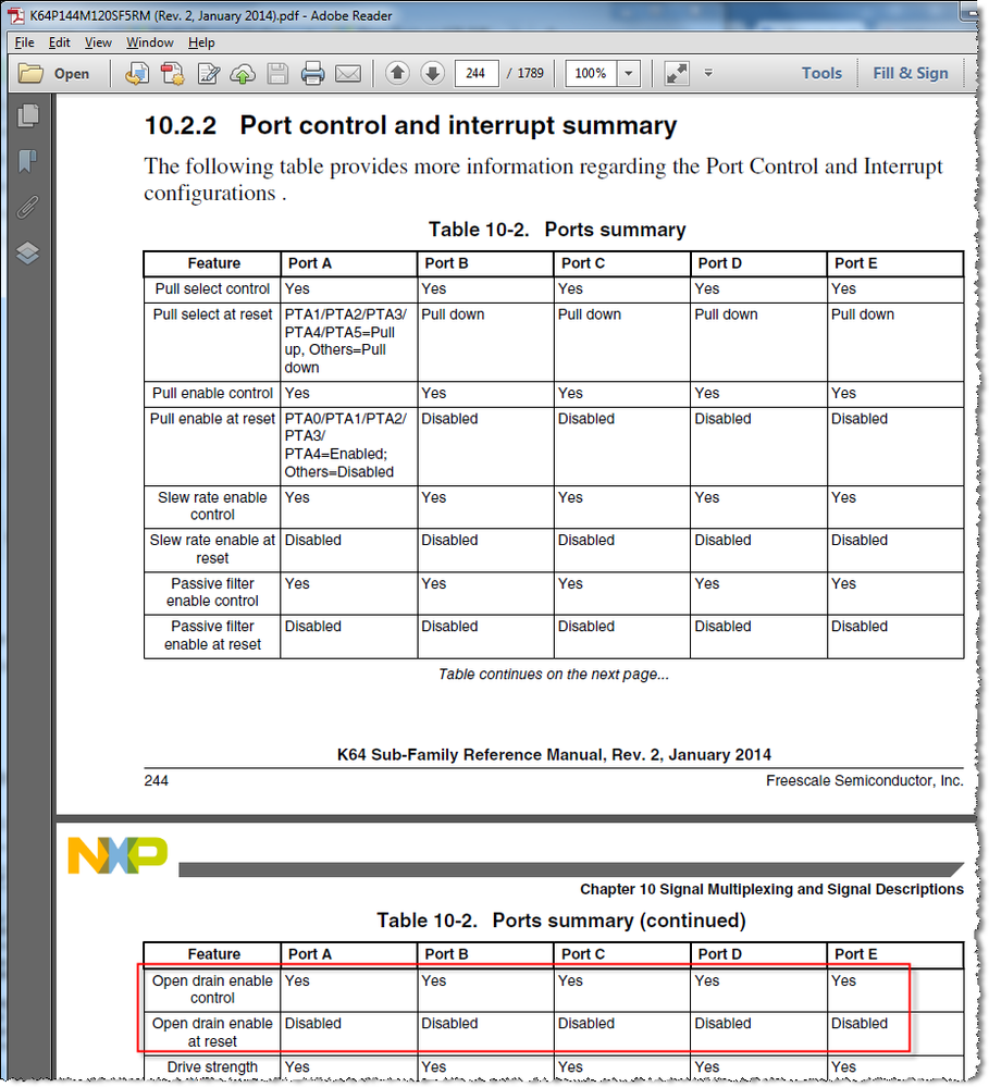

These information should be descripted in section "Ports summary" of Reference Manual. For the newly updated Reference Manual(for example K64P144M120SF5RM, you can find the section "Ports summary" ) But the documents of K40 have not be updated for a long time.

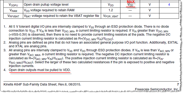

In my opinion all the GPIO of K40 support a configurable open drain output.(You can have a test: when configured as open drain, these pins can't output high level voltage.) But it's not true open drain, thest outputs must be pulled to VDD.(can't be pulled to 5V)

The table you showed from the K65 manual does not appear to be in the K40 manual.  That is at the heart of the problem.  The KL43 manual has a similar table showing NO open-drain outputs.  What would the K40 table show, if it existed?  I think your implication that it is likely that all ports have open drain provision is probably correct.  It would be helpful if Freescale/NXP could actually state in K40 documentation which ports or pins support open drain outputs for the K40, rather than leaving us to guess at the answer.  Perhaps it exists in another document??

The 5V tolerant pins were meant for dedicated inputs, not bidirectional data. If you want to use the K40 communicate with 5V device, maybe you need place a SN74LVC1T45.

The comments by Robin are consistent  with the results I obtained with a K22.  The pins are only 5V tolerant inputs.  Using them as outputs, even in open-drain mode they are clamped to Vdd.
A bit disappointing.  It looks like you have to use a 5V family for true compatibility.
