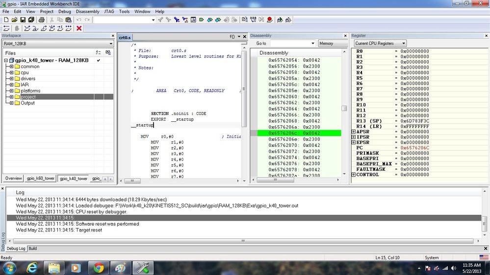

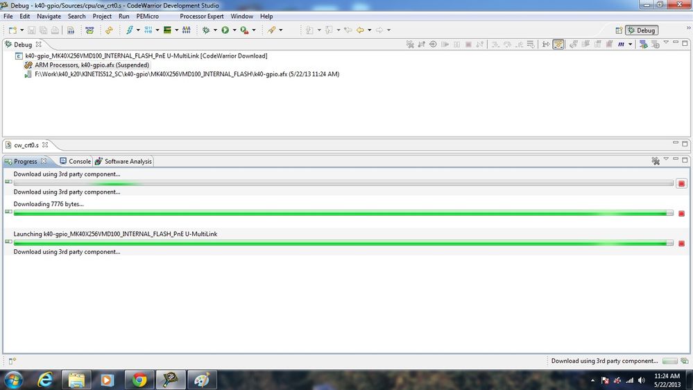

Earlier I was getting error as "The flash loader program reported an error" when trying to Download & Debug in IAR using P&E USB Multilink Universal tool with TWR-K40X256 board. At that stage the Code Warrior was giving the pop info as "Device is Secure, Click to Unsecure". I have selected it to Unsecure the target in CW pop info, but the process got failed at the end. Somehow the efforts which CW made to unsecure the target caused the IAR to Successfully  Download and Debug the Flash.
But now I am facing the different error as "Programming the Flash" pop info is not progressing up in IAR with FLASH_256KB_PFLASH_256KB_DFLASH and also in Code Warrior the process is now getting hanged at the stage of  "Download Using 3rd Party Component". This type CW is not giving the error as "Device is Secure". It is trying and hang.
Please see the Console log message from the CW  when I tried to Flash the Target with Debug Configuration set to "INTERNAL_FLASH" at the end of this Message. I have attached the Debug Configuration Image and the hanged state of Code Warrior also.
Yes, the code gets downloaded with [RAM_128KB] configuration but I am not able to debug it properly and also it is not executing perfectly.  The SP and PC are pointing to a memory section which is reserved.
I am attaching the screenshot of the SP and PC state. Please have a look to it.

Console Log Messages (CW):

Hui_Ma
I get the feedback from IAR engineer.
First, please check the General Options -> Target -> Device settings.
TWR-K40X256 board, please select * MK40DX256Zxxx10 product.
Then, Disable Debugger -> Download -> Override default .board file.
Please refer attached picture for detailed info.
After that, I could use P&E USB Multilink tool to debug the Flash target project.
When you debug the SRAM target, the correct PC address should be 0x1FFF0410.
I am quite doubt your TWR-K40X256 board status.

gagangarg
I have done as per the configuration you said, but still it is not working properly. The program is downloaded on the RAM but executing unexpectedly. The SP is pointing in reserved memory section and the PC is 0x1FFF0410 only in the beginning.
Do you think the processor is locked accidental and restricting in writing to Flash?

hesane
Hi gagan garg,
My custom application has the same issue that you reported here and I already tried to fix follow all orientations posted here but the issue continue happening.
I checked that K40 is not secured and I run the mass erase in CW. The code is loaded perfectly in my reference design of the Freescale but when I try to load the same code with the same IAR configurations and debugger PE Micro Multilink in my custom board the code keep "locked" in the crt0.s in debug mode running step by step (like your print screen of the crt0.s file that you attached here). The solution is not posted but did you solve this problem?
