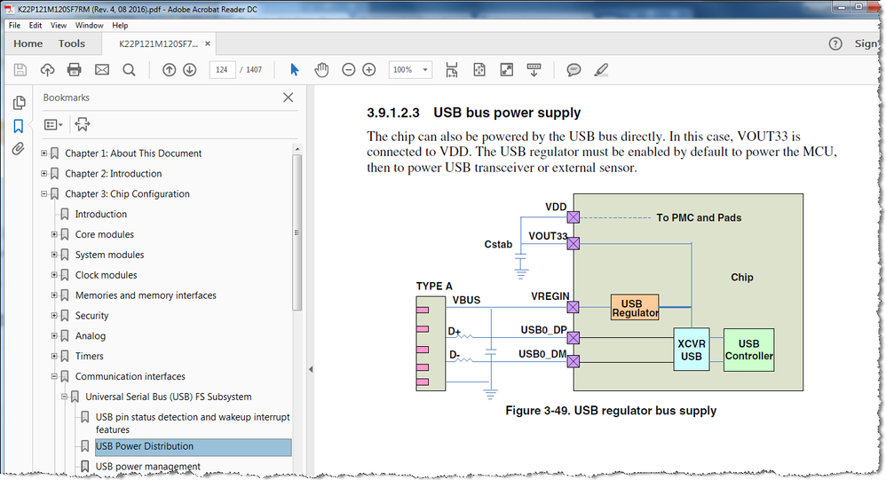

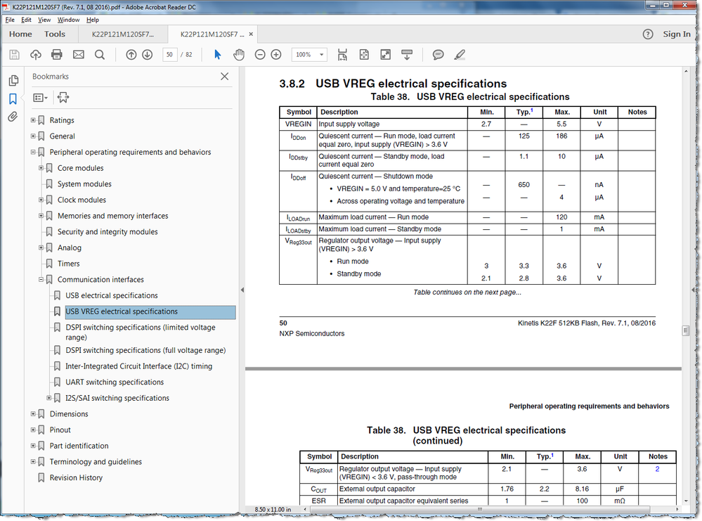

Can I use Vout33 (output of internal LDO) to actually power the device.
1,129 Views
Robin_Shen
Hi Phil,
You can use Vout33 (output of internal LDO) to power the device. Please refer the 'Figure 3-49. USB regulator bus supply' of K22P121M120SF7RM.
See also the '3.8.2 USB VREG electrical specifications' of K22P121M120SF7.
