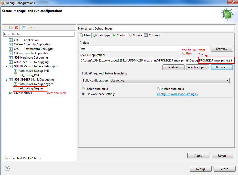

hi,
I need to flash"Kinetis K22F MCU flash *.efl file without projct" in the factory side.
#Solution 1, "Flash from file..." in KDS, but don't work if without project. You know, we don't want to open code to the factory side.
#Solution 2, If there is a CMD option in KDS, to transfer *.elf to *.hex file or generate *.hex file. and then I can use J-flash SW tool to flash the chip.
Kent
1,585 Views
Hello Kent,

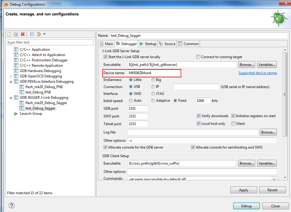

For your solution 1 : You needn't open your project ,  you can utilize the  any simple project when flash ,
                                only need choose the .elf file you want to flash , as this :
pay attention , configure correctly of the debugger , for example , if use the J-link ,  configure the correct "Device name"
