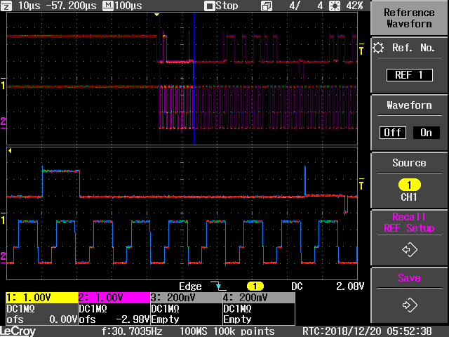

To All,
Am running simple i2c test with 2 ea K20 talking back and forth to each other.
I am running into a couple of issues I haven't been able to explain.
I've been playing around with the pin control settings.
PORTB_PCR0   SCL
PORTB_PCR1   SDA
1.   code works when PCR's set to (ALT2 + ODE + PE).  However, the Low signal levels look bad on SDA (around 1V).
2.   Code does not work when PCR's set to (ALT2 + ODE).  But, low signal levels now look correct.
Is there any reason why i2c module requires a PULL DOWN Resister enabled?
I have external pullups on both SCL & SDA (I think they are 4.75K but I need to verify this)
Tried changing Pulldown to Pullup and no activity on bus at all with that config.
It acts like the Master cannot pull the bus completely low when the internal pullups are enabled.  And cannot see RX Data from the slave unless the pulldown is enabled.
Any Ideas?   I'm beginning to wonder if I've missed another config parameter somewhere.
-Roger

rthornblad
Hi Kerry,
I figured out the problem.  I screwed up the configuration in both Master and Slave parts..  Not sure why the level issues are not present when the slave module connected to the FPGA.
In any case I'm good to go.  it seems the moderators are pretty busy so I'm not sure when this will really post.
Thanks for your help.
-Roger

Hi Kerry,
High voltage is 2.5V with the external pullups.
Removed the external pullups as a quick test and tried (ALT2 + ODE + PE+PS(1)).
i.      SCL is constant @ 1 Volt
ii.      SDA is constant @ 0.3 Volts
iii.      No obvious transitions on either line now
Attached are 2 scope captures
i.      2 are communicating but the SDA line has the 1V low
Config Reg is (ALT2 + ODE + PE+PS(0))
i.      2 are not commnicating.
ii.      Levels being issued by the Master seem OK.
iii.      Slave fails to pull ACK bit low
Config Reg is (ALT2 + ODE + PE+PS(1))
If I disconnect the slave device from the bus the levels return to normal  Almost looks like in slave mode a DC level is being output on the 2 lines...  hard to believe that but ???
-Roger

kerryzhou
Hi Roger Thornblad,
    1. Please tell me what the K20 detail part number you are using.
    2. What the high level voltage on your I2C bus? 3.3V or others?
    3. Try to modify your external pull up to 10K.
    4. ALT2 + ODE + PE+PS(1), the test the I2C bus wave, if still have problem, please also share me your I2C oscilloscope bus wave.
Waiting for your updated information.
Kerry
