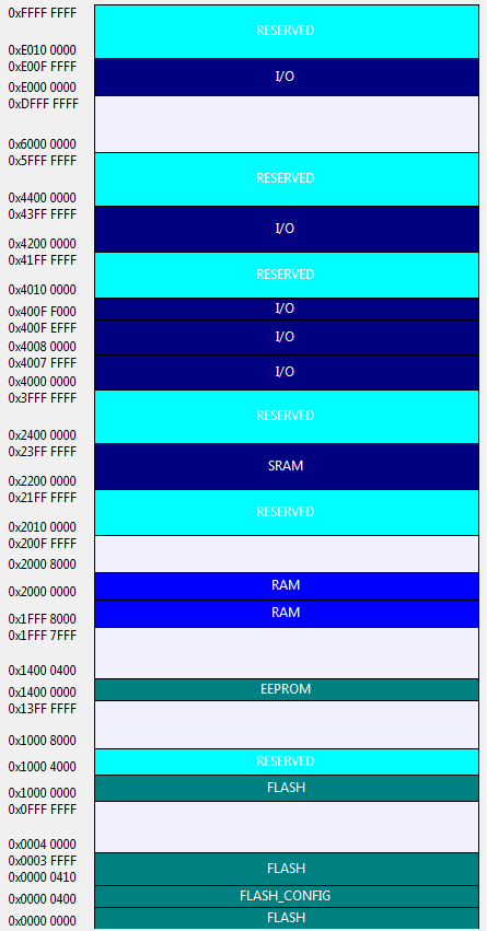

I'm working with Kinetis K20 with two memory banks. In a hand it has 256 KB of Pflash for code program. In the other hand it has 32 KB of NVM that can be configurated like EEEProm memory.
If I use 1 KB of EEEProm memmory (16 KB of FlexNVM). Can I use the other 16 KB of flexNVM for PFlash?
I use bootloader for my application too.
Is it possible? In this case, will it run fine with the bootloader?

Hi Miguel,
Yes, you may use the other 16KB as PFlash, but please note in the linker file you have to define two seperate sections for them instead of one section, becase their address are not continuous.

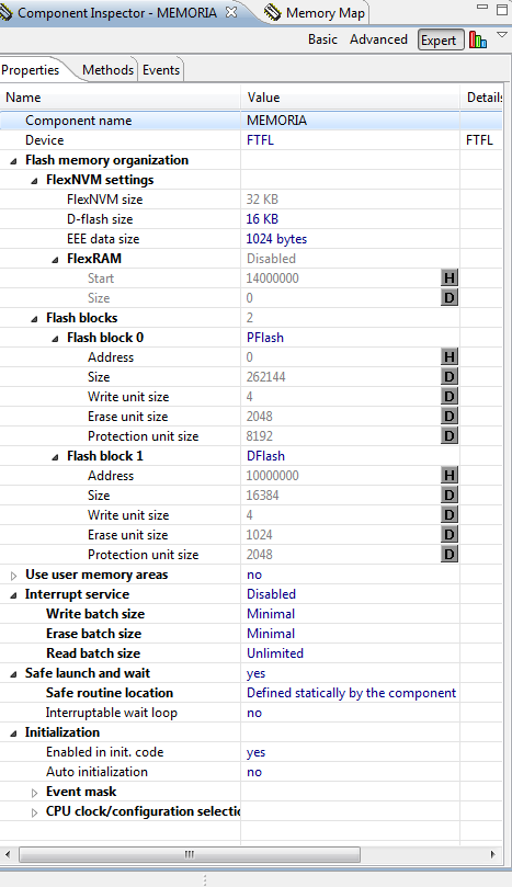

Hi Kan,
I do it but it doesn't compile. Now it returns me overflow in code1:
"Overflow in segment: code1 from section: .text1 Segment reserved size is: 0x00004000 -- Overflow of: 0x00006ec4"
I try to do the program code smaller, but doesn't works. The code size is always smaller than 270 KB.
Have you got any idea about it?
The memory configuration is correctly, I can see it in memory map and it is OK. I attached you the actual configuration with processor expert.
Very thanks again for your answer and for your help. It's important for me.

Kan_Li
Hi Miguel,
Seems the rodata section is larger than 16KB, so maybe you have to divide it into two parts, one placed in text, and the other placed in text1. I suggest using the following method to do that:
