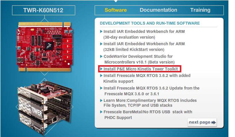

Did you installed the P&E Micro Kinetis Tower Toolkit?
This file installs the OSJTAG and the USB-to-Serial Drivers.
You can find this file in the Flash application that comes with the CD here:
Also try to run the K60 Board without the TWR and the Serial Module.

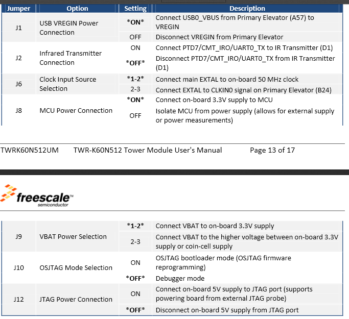

Check if the jumpers are configured like this(Follow the Bold config):

What document did you get that table from? I'm using the TWR-K60N512 Quick Start Demo, Lab Guide for MQX 3.7, revision 6. Anyway, my jumpers weren't all set like that; there appears to be some disagreement between your document and mine. But, I changed them to the settings you reference, and there's no change in behavior.

I got that document from my K60N512 DVD.
